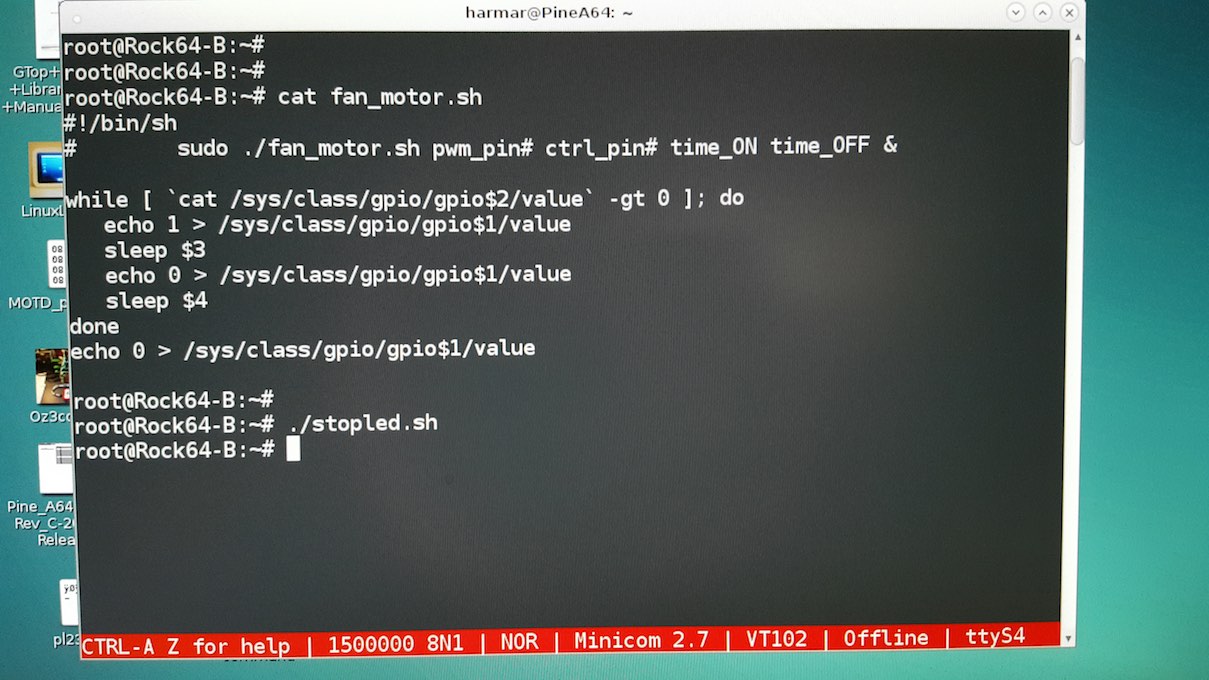

The simple driver script is listed below, and is also visible in the terminal pics below:
fan_motor.sh
#!/bin/sh
#        sudo ./fan_motor.sh pwm_pin# ctrl_pin# time_ON time_OFF &
while [ `cat /sys/class/gpio/gpio$2/value` -gt 0 ]; do
  echo 1 > /sys/class/gpio/gpio$1/value
  sleep $3
  echo 0 > /sys/class/gpio/gpio$1/value
  sleep $4
done

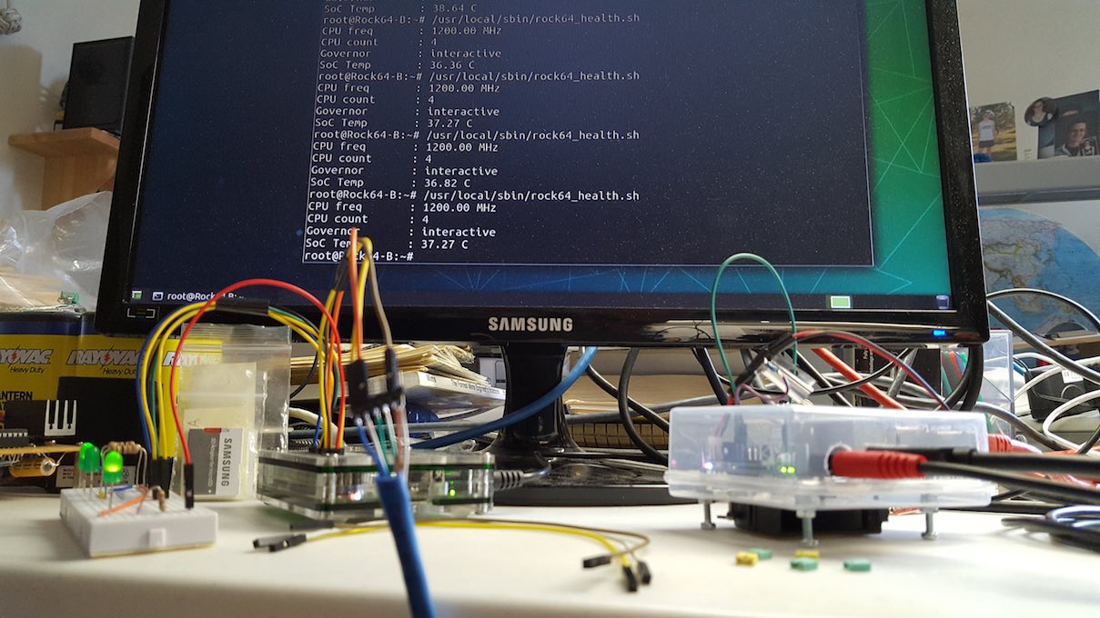

The pic at the far right-hand is the fan happily spinning away !  The other two pics are views of the control terminal and the commands used to control the 2N2222 transistor bias.  The code sets up a loop that monitors the control pin ( in this case gpio83 ).  gpio83 must be set HIGH to run the loop, which runs in the background.  Momentarily pulling the control pin (83) LOW causes the loop to break and the motor will stop ( the control pin is on parm $2 ).
The control loop turns gpio(82) ON|OFF using parms $3 and $4 with a slow duty cycle in this case of 75% ON, and a frequency of about 6cps;  for a brushless fan this is perfect for keeping the fan running ( very nice airflow ) but with greatly reduced current and far less noise !
The stopled.sh script is simply a three line script that pulls the control pin low for 1.5 seconds and then releases it.  This breaks the control loop effectively stopping the motor.

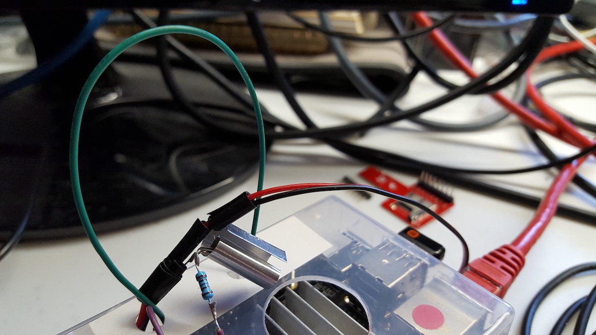

You may use either a PN2222, or a 2N2222 transistor.  Notice the transistor is placed in the black lead ( negative ) of the motor assembly ( pay attention to the emitter | collector designations on your transistor datasheet! ).
Don't forget the base biasing ( current limiting ) 1K ohm resistor;  a common mistake.

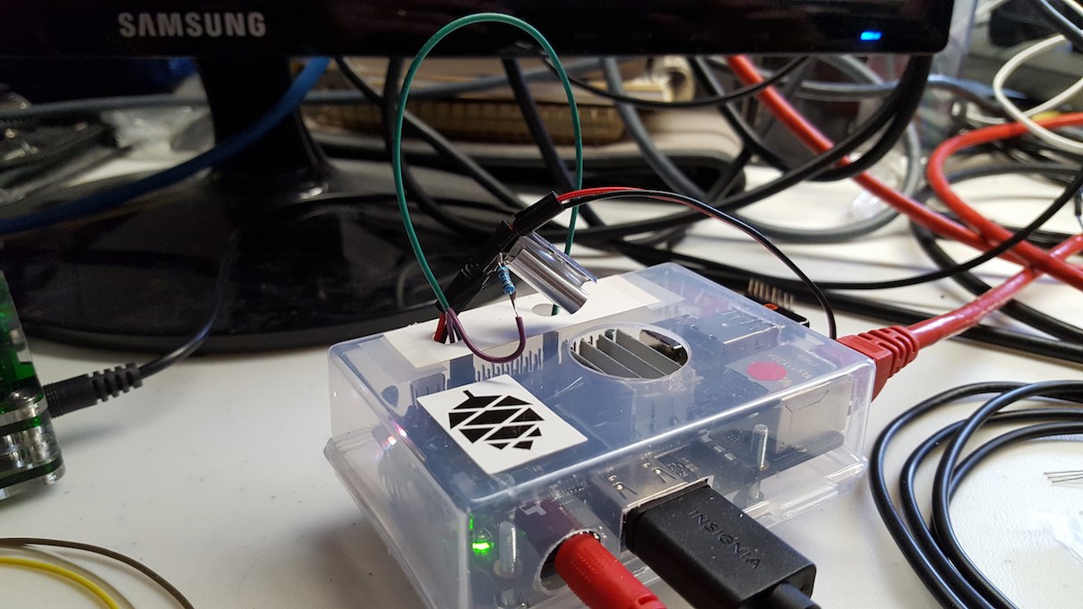

The pics above detail the finished prototype;  the only difference here between the prototype and the completed project is that the completed project will have internal wiring ( including the transistor heatsink, cable, and biasing resistor ).
There are several things to notice in the pic top left;  my fan projects ( active SBC cooling ) all use heatsinks on the driver transistor.  This keeps the cost low, while still improving the life of the transistor.  Commercial ones are available, but I made this one from inexpensive brushed aluminum from a jewelry hobby store.
Notice the hole in the top cover over the SoC heatsink.  The inductor blower fan evacuates the case hundreds of times per minute, and the entry point for that airflow is directly over the heatsink fins.  To accomplish this the other openings in the case need to be minimized ( note the temporary gpio cover , taped index card with hole punches ).
The fan is mounted on the bottom of the case which is not only more aesthetic (IMHO) but its also quieter when placed there ( from experience! ). The finished project will deviate from this prototype by adding a foam-slit cover for the gpio(s) and by adding a lite surgical gauze filter for the airflow entry point;  this also helps to keep the board and the fan blades clean and quiet.
Please note the green loop of wire on the gpio PI-2 bus;  this wire runs from gpio89 to gpio83, and is used to signal the fan_motor.sh control loop when to break.  gpio89 is held high;  when gpio89 pulls gpio83 low, the control loop breaks and the fan_motor.sh script exits ( of course the fan motor then stops spinning ).

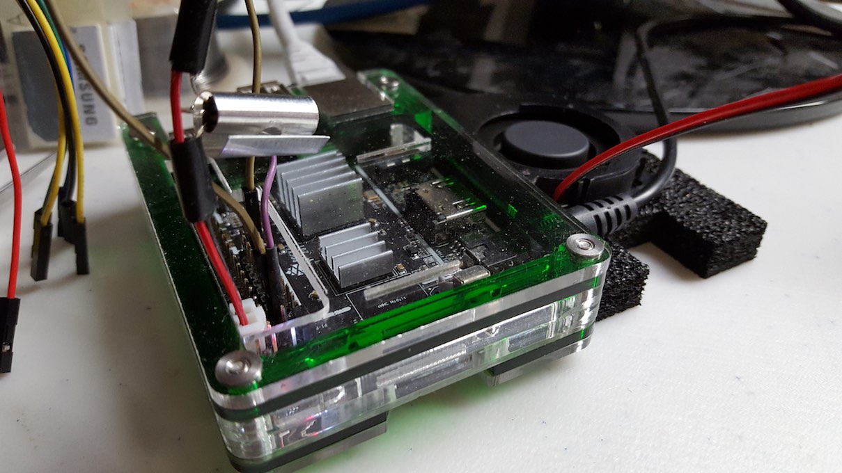

The induction blower fan is seen in this pic (above) mounted on the bottom case of the Rock64 clear shipping case.  Again, the final will have internal wiring.  The fan blades are quite powerful even at lower soft-pwm speeds. The induction blower assembly evacuates the case air exhausting it out across the bottom under the case ( virtually silently ).
This required a considerable amount of dremel work ( don't forget eye protection and filter mask while breathing ).
I mounted the blower assembly with two small machine screws ( M2 ) cut to proper length with a dremel cutter wheel.  The holes in the bottom case are just a tiny bit smaller than 2mm, so that the threads of the M2 metric screws bite into the plastic housing without any other hardware ( like washers, nuts, etc ).

The pic above shows the prototype ( lower right foreground );  note the fan assembly position -- it is important to have the mounting 'feet' (M3 stilts) long enough that the fan assembly clears the table top;  otherwise, the noise from the fan will be transmitted to the table ( not good ).  The final project will have little rubber footies on the M3 bolt tops which will further reduce what little noisy vibration might be left over.
On the Samsung display ( background ) you will notice some Rock64_health.sh readouts. My idle temps with this setup ( 1200 Mhz ) are in the mid 30 ℃ , and even loaded most times the temps are in the high 30 ℃ to low 40 ℃.

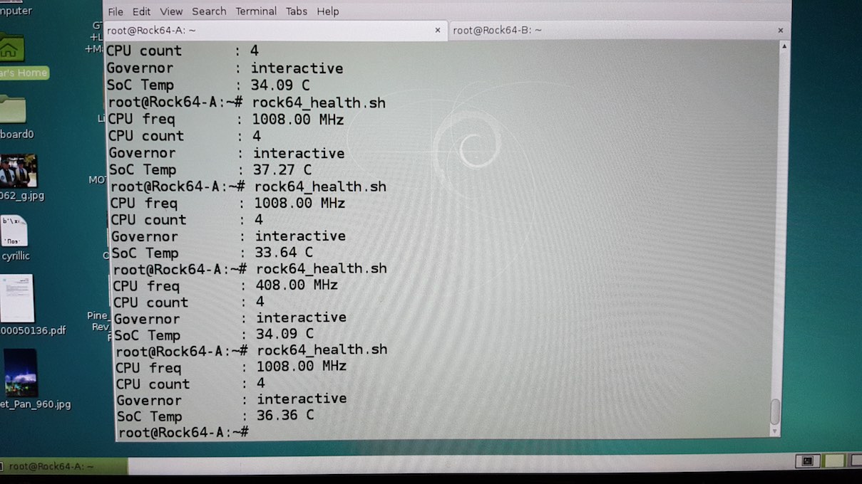

The Rock64-A machine is cased in Dustin's C4Labs acrylic Zebra case ( Emerald ) .  The induction blower assembly is positioned behind the Zebra case, and the plastic insert on the power edge of the Zebra case has been removed.  Cool airflow is forced across the heatsink fins and is exhausted out the top via the gpio(s) port opening.
This is a more efficient system than the Rock64-B enclosure, as you can see by the health report(s). The fan assembly is mounted to a foam block ( very quiet ) which holds the induction blower at just the right height to match the opening.
