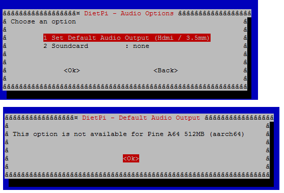

I tried dietpi but it looks like it doesn't support the onboard audio ("This option is not available for the Pine A64...").  Thinking I should have went with a raspberry pi now... The Pine64 is an amazing board but might not be the right one for me. This is the 3rd or 4th OS I've tried on the Pine64, haven't been able to get headphone audio out of any of them.
Quote:root@DietPi:/tmp# arecord test.wav
arecord: main:722: audio open error: No such file or directory
root@DietPi:/tmp# cat /proc/asound/cards
 0 [sndhdmi        ]: sndhdmi - sndhdmi
                      sndhdmi
root@DietPi:/tmp#
