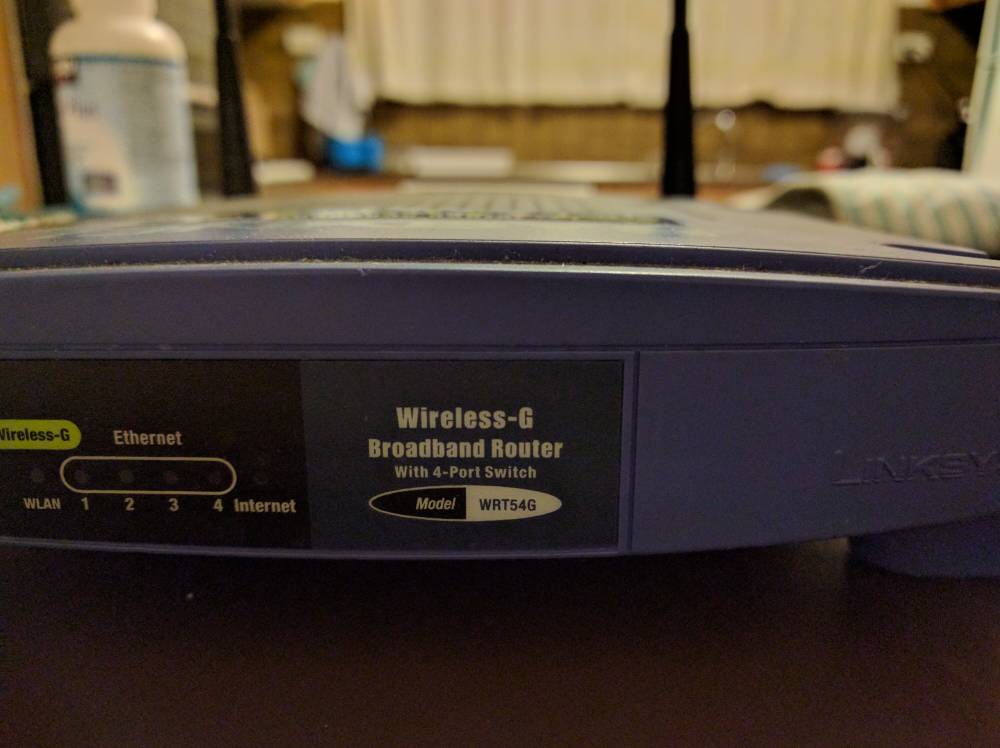

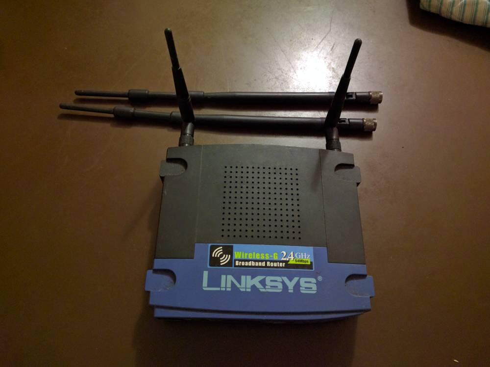

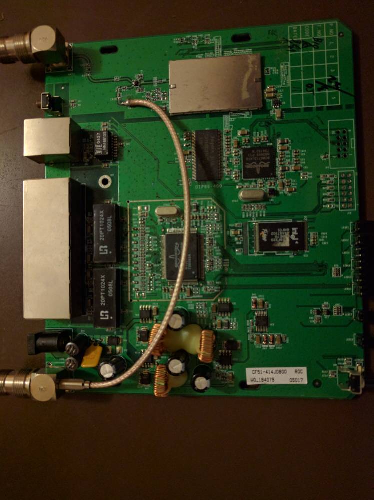

my next step is installing this in an old wireless router with a battery.
more is to come. i will be adding some exploits like metasploit and some MITM attacks like sslstrip and such. this is just the base setup. i remember there was a web interface for this. just dont remember what it was called.
edit: i added macchanger to the wifi tools. cant believe i forgot it.
I went through some of my crap and found this old linksys wrt54g router and the big external n-type connector antennas.

when your moving house you tend to find stuff you forgot about. I just came across this router that I had running open wrt for a while.
[Image: cc596210dfd3b409267b7db59691655f.jpg]
looking at the back pannel it looks like the rp-sma connectors are pannel mount.
[Image: ea0be5905aaf52bc079f553f8acdf3ea.jpg]
pulling it apart it has coax fly leads coming off the rp-sma connectors. This makes mounting the wireless cards a lot easier. Also there is pleanty of space for the pine and the battery pack.
[Image: 32c44914a8d8b532b1576a148b4dc68e.jpg]
