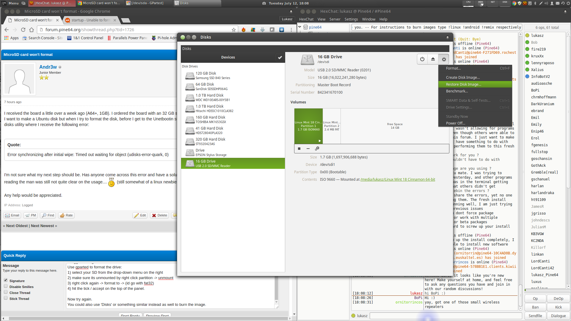

You could also use 'Disks' or something similar instead as well to burn the image.
With Disks you can use the restore function to burn the image (see picture in attachment)
