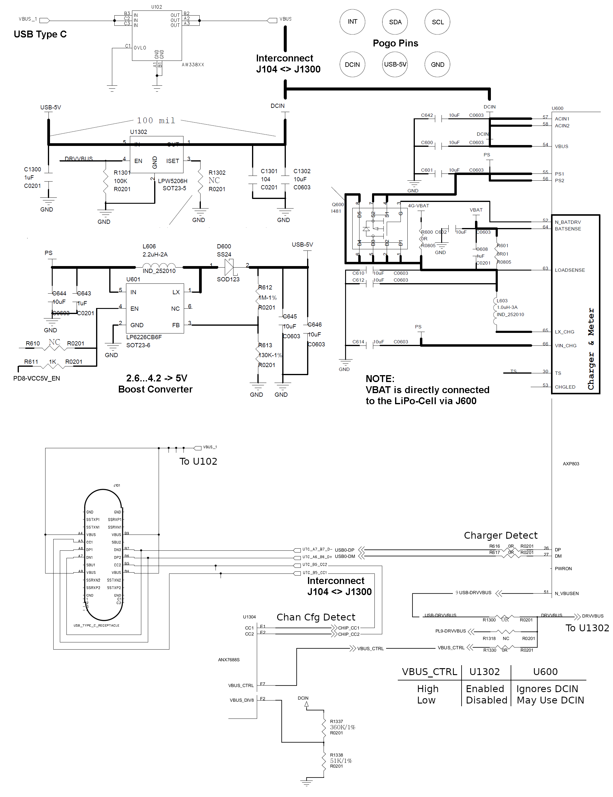

It seems that when the keyboard is connected and supplying power the USB C port on the phone should sink power but also act as USB host...
So I wonder:
Is there any way to switch the USB C between sink and source modes from user space?
Is there any way to switch between USB host and device mode from user space?
On postmarketOS, when the keyboard is not attached, the USB-C hub obviously works well with the phone (peripherals + HDMI), but only when external power is fed into the hub. This restriction is probably imposed by the OS.
When the keyboard is attached, I never tried the hub in the phone's USB connector (there's waaay too much ambiguity everyhwere I've read), but connecting the hub to the keyboard's USB connector does not work at all. Even if the keyboard is providing power (I pressed its button to start charging the phone).
I'm assuming the following should work, but I've never tried: to connect the hub to the phone's port, without feeding external power into the hub, but enabling power from the keyboard alone. That's because the keyboard battery is wired directly to the phone's USB power line, so the hub will act as if it is powered from the phone, and the phone will not send power to the port at all, relying on the keyboard only?
It's almost as if the OS is already smart enough to make this work, it looks like it, but I'm too worried to try. Would this make sense?

However, the powerbank aspect of it is more ambiguous. On postmarketOS it behaves properly (charging on/off works), but I can't seem to find the device files that are supposed to represent the powerbank within. The keyboard has a chip that controls charging, which should present itself as a `power_supply` device. But it doesn't show up on my phone.

Hi all,
Hesitating to post to a resolved thread, but noticed talk of pogo pins and plugging power sources into each other and what not. A while back, a few of us went on a deep dive about how the pogo pins work and how they interact with the USB C port.
Attached a pic: collage of relevant parts of the mainboard and the USB C board. Lots to unpack there... but it shows how all of this connects and where things are controlled. Yup, there are different aspects controlled by both software and hardware. Yup, if you plug the wrong things into each other, it is bad.
The thread with long-winded discussion for anyone curious here. That's where the pic came from
