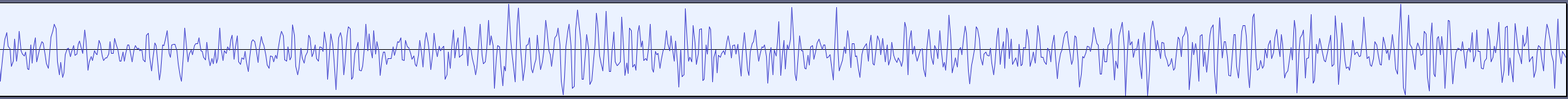

I made another graph recording directly the from mic, also the wave;
@bcnaz Look like the same bug ! I wonder how many has this !
I forgot, I also have the vibrator broken. Could be related ? a usb-board hardware problem ?
