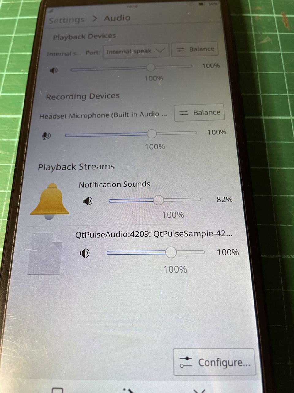

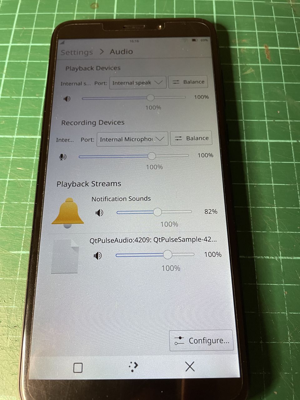

Currently the installed OS is Manjaro with KDE Plasma Mobile. Just after the full OS is loaded, under Settings -> Audio, in "Recording Devices" section, the Internal Microphone is shown:
After tapping on the button and sellecting the "Headset Microphone" there is no option to go back to the "Internal Microphone" (see the image below):
In my opinion this looks like a software issue. If I use a headset, the microphone on the headset works fine and, if I make a phone-call, I can have a bi-directional conversation.
Any feedback? The next step would be to replace the main board. Or sell the phone on eBay and put a stop to my misery
this is a painful situation with Plasma's settings, click Configure and try to disable the audio selecting Profile Off and then select again the High Quality music profile, you can also try to connect and disconnect the headset and you will probably get your settings back
(07-24-2021, 03:38 PM)mouffa Wrote: this is a painful situation with Plasma's settings, click Configure and try to disable the audio selecting Profile Off and then select again the High Quality music profile, you can also try to connect and disconnect the headset and you will probably get your settings back
Thanks for that, mouffa. I managed to bring back the setting for the Internal Microphone, however, it still doesn't work. I should have mentioned that the mic is not working irrespective of the installed distro. It looks like it is a hardware fault, after all.
