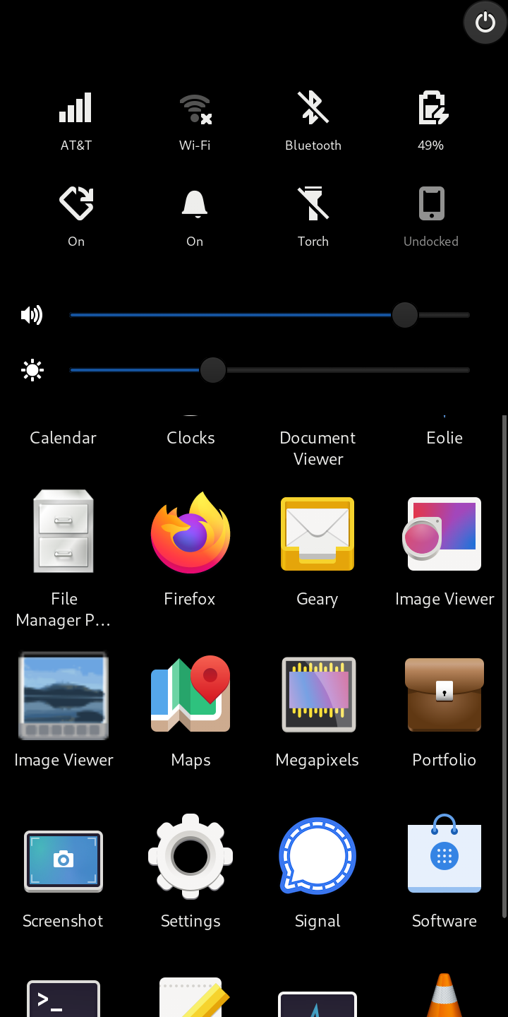

In Phosh, the Power OFF is in the pull down from the top. (Single tap, DO NOT swipe down, to get the menu)

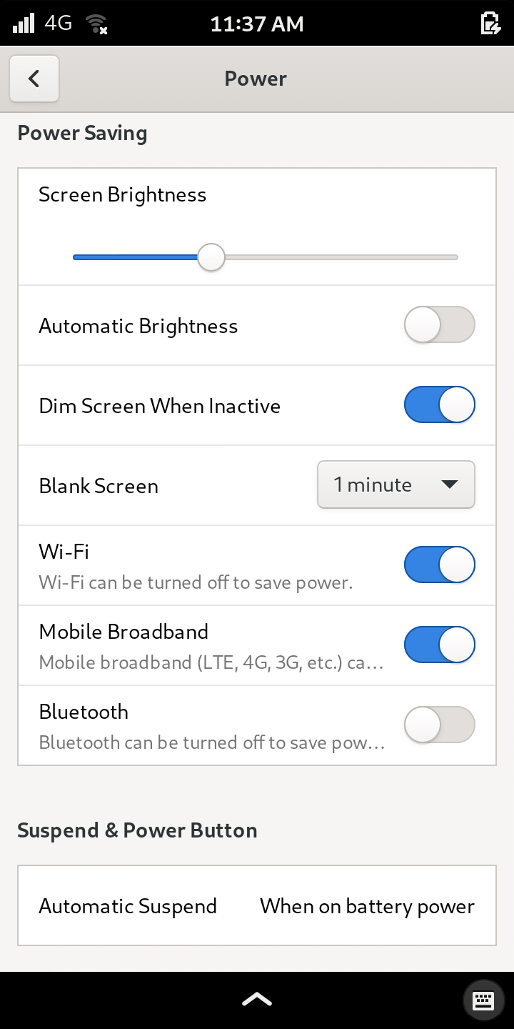

In Phosh, there are settings for power save.

systemctl suspend. Cool. I turn auto updates off to save battery life as well. The hard part is making sure the darn thing isn't in airplane mode. what a pita to discover you can't recv calls. That's the only reason I bought it. Of all the phones I've ever owned I doubt I've used airplane mode even twice. Tap the notification bar and then the power button in corner. Voila
