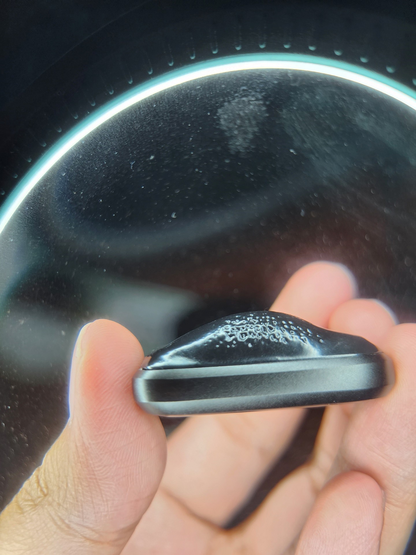

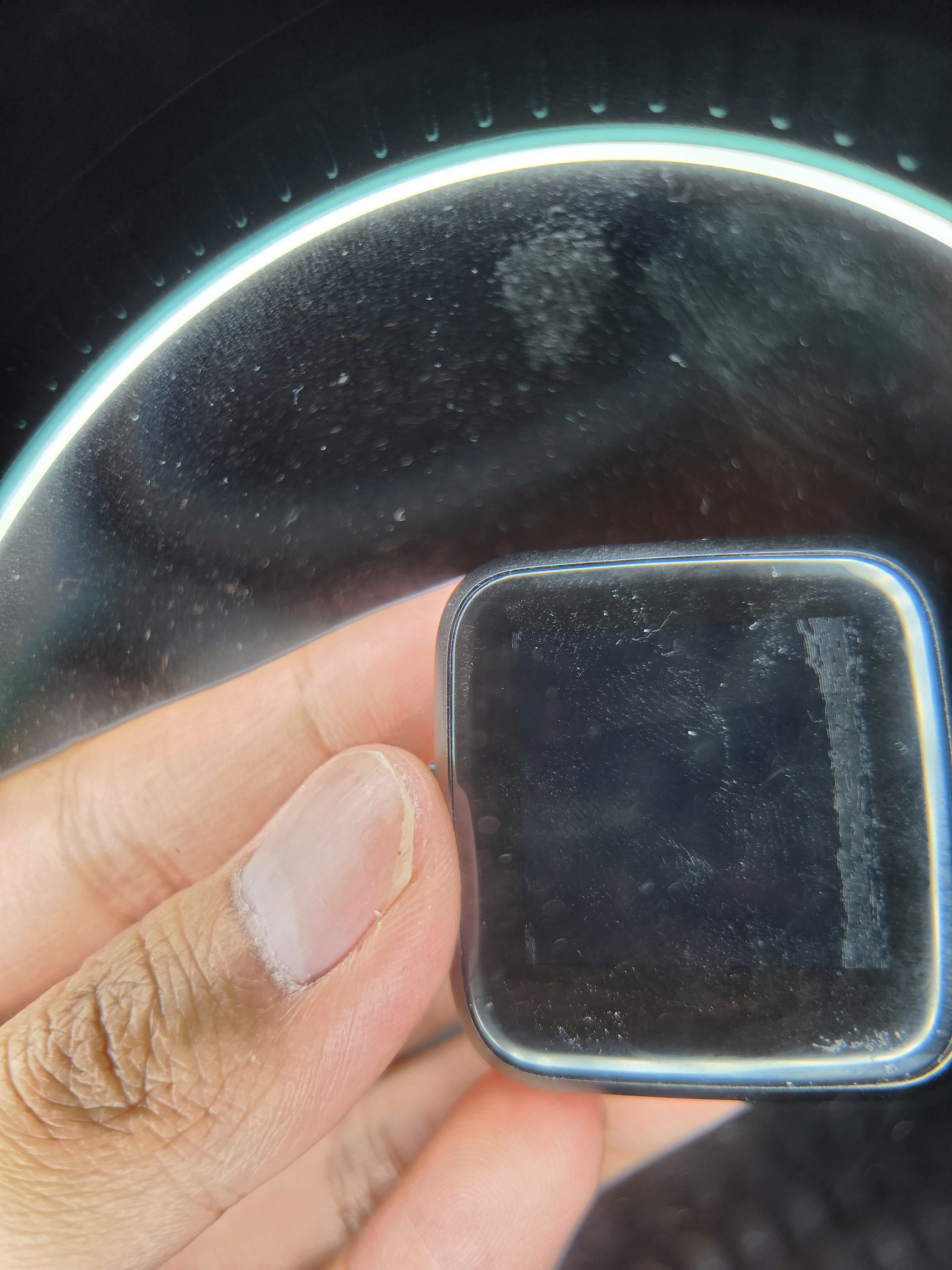

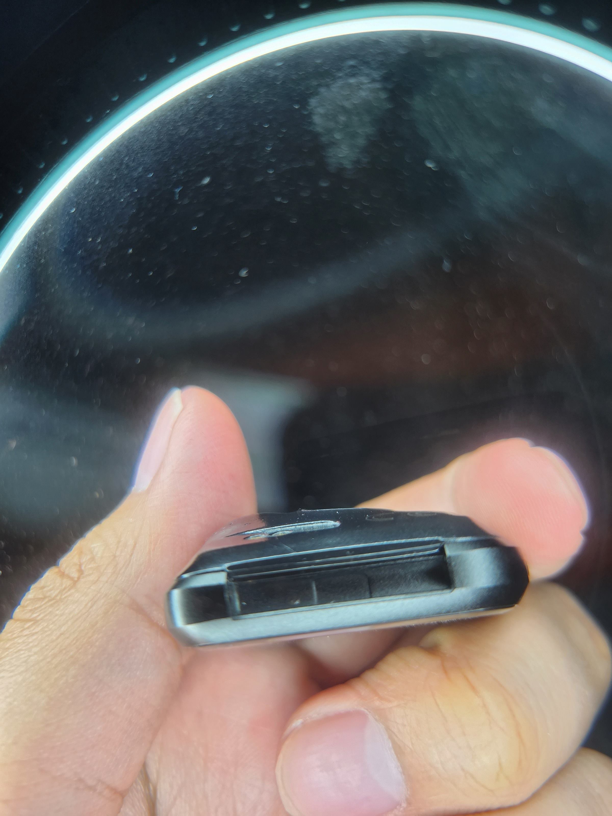

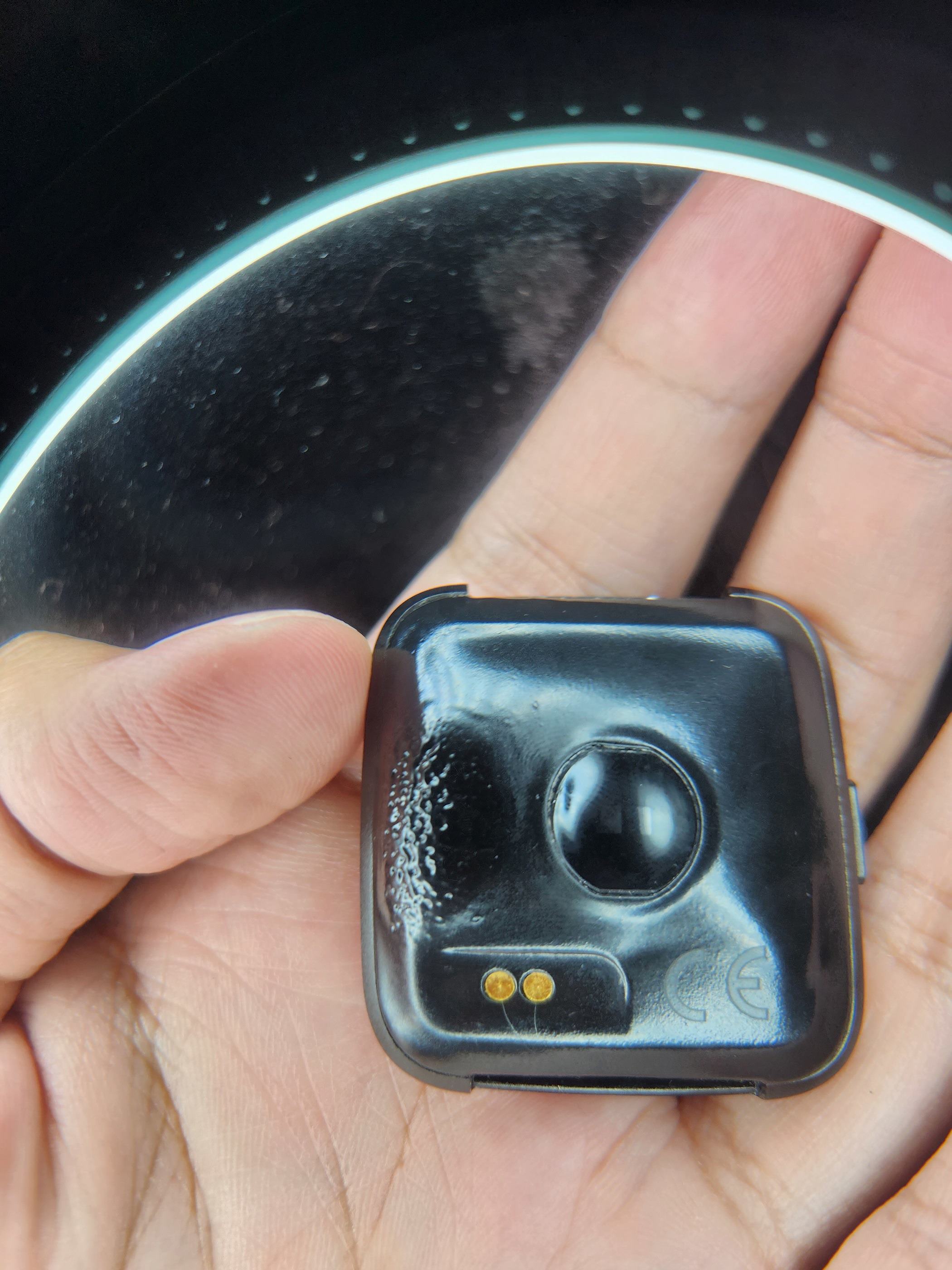

Hello All,
PineTime newbie here. When I attempted to open my sealed PineTime, I ended up warping the plastic instead Sad
Even though the phone looks damaged, I still want to open up the watch.
During my attempts, I was never able to open up the watch (to the point where I ended up warping the plastic).
 Does anyone have any comments/suggestions so that I can finally open this dang thing Confused
