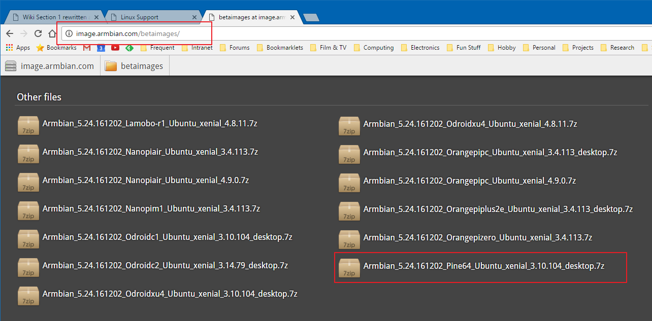

Um... why are you compiling anything? As it says in the pine64 docs for Armbian, the support is there... so you you need to do is download the beta image from their site (second last entry). Saves you the hassle of ensuring your system is setup up properly for compilation and waiting around for it to compile! Wink And preferably use a proper disk imaging tool like Etcher that actually verifies the the image is written, so you minimise the chance that you'll have issues with faulty SD cards.

5.20 is the current release build, 5.24 (desktop) is the current beta, and 5.25 should't be too far away. Try that image, and make the changes noted at the bottom of the pine64 armbian notes re: 5.24 LCD support. If it doesn't work... yell and scream at tkasier over on the Armbian forum... as he wrote the docs saying it works! :-P But seriously, let us know how you go...
