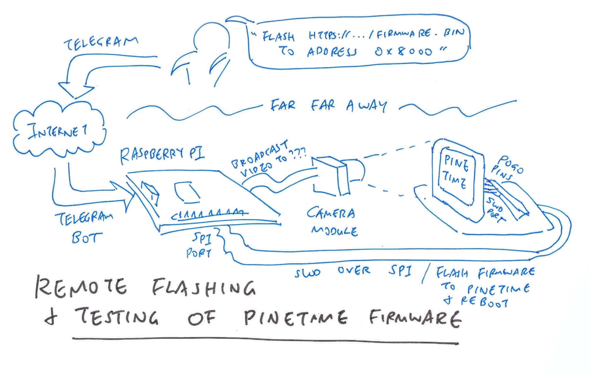

Remote PineTime for flashing and testing firmware remotely
I have set up a PineTime for flashing firmware and testing remotely...
1. You can send flash commands to the Telegram Bot...
    /flash 0x0 https://.../firmware.bin
2. Then view the live video stream of PineTime on YouTube
Hope this will encourage more people to try PineTime programming. More details here...
https://github.com/lupyuen/remote-pineti.../README.md
(09-20-2020, 04:41 PM)lupyuen Wrote: I have set up a PineTime for flashing firmware and testing remotely...

Thanks! Please go ahead and try this out... Maybe when I get my PineCube I'll use the PineCube webcam instead [emoji3]
Remote PineTime now lets you view debug messages via Arm Semihosting. Check out the demo video here...
https://youtu.be/mMLWgzJSAGI
Implementing Semihosting in your firmware is easy. Here's the code that you need...
https://github.com/lupyuen/remote-pineti...emihosting
Why Semihosting instead of some other more efficient logging mechanism?
Because Semihosting is really easy to implement in our firmware (and also in the Remote PineTime Telegram Bot). It's a simple way to troubleshoot PineTime firmware as it runs.
It's not a good idea to log too many debug messages via Semihosting... But then again we really shouldn't be doing too much logging in our firmware :-)
