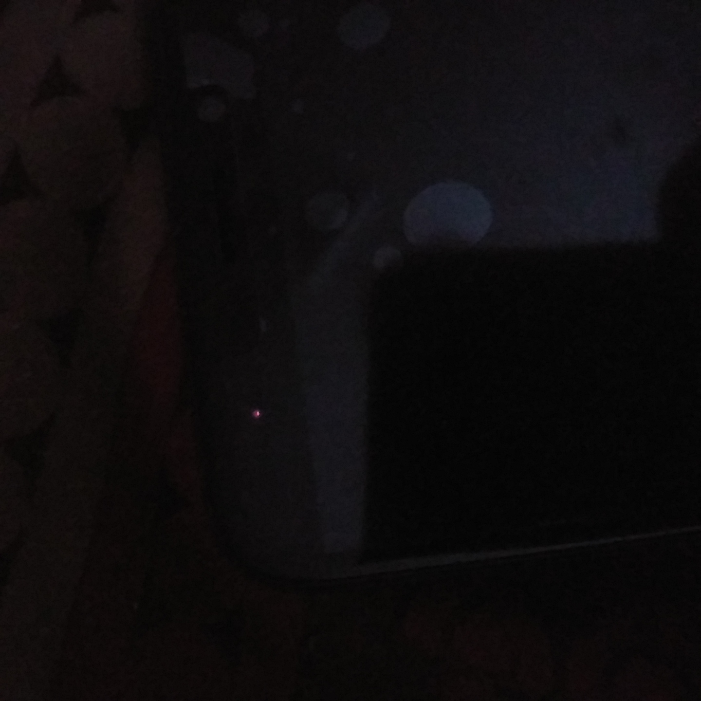

It would appear that my phone not only has a working camera, but a third camera. Curious as I am, I am not all too surprised.
anyone?
.jpg   Dark_camera.jpg (Size: 459.2 KB / Downloads: 829)
How did you get this? Is it on the front? Could be an infrared camera that could be used for face unlock. My laptop has one and I think that's what it's used for.
I'm confused ... what is this exactly?

The blinking purple light you saw on the camera is the proximity sensor.

(07-21-2020, 07:41 PM)Danct12 Wrote: The blinking purple light you saw on the camera is the proximity sensor.
Bullshit, proximity exactly to what? Also, unless I have some one off version then I imagine they all have this. As far as the facial recognition comment why wouldn't this be listed in spec notes/ be something that a niche of people are working on improving like the actual camera, or the excessive heat problems???

Also anyone have a link to design schematics? I bet it's not on there or not labeled.

Before calling 'bullshit' you could check the documentation linked in the wiki - particularly the schematic and the bottom placement pdf. You'll find the proximity sensor is U1201, located between the LED that you may see at boot, and the headphone socket. It contains an infrared LED and a light sensor which, among other things, reacts when the infrared reflects back into the light sensor off a nearby object, such as the side of your head when you're holding the phone to your ear and don't really want the touch sensor working or the screen backlight wasting power. You can even take the phone apart to see if it's there on the pcb, and how it compares to the cameras.
Edit: the wiki link to the datasheet is broken. Manufacturer's product family page:
https://www.sensortek.com.tw/index.php/e...-with-als/
