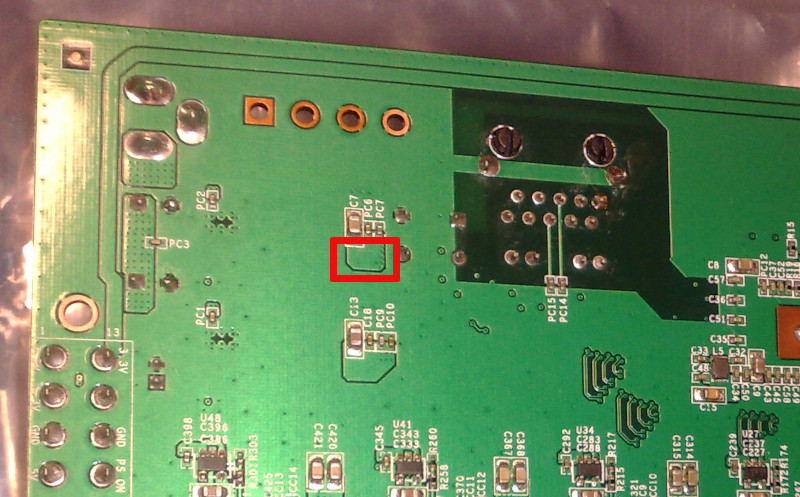

#19
(04-20-2021, 01:20 PM)dsimic Wrote: Adding an SMT Schottky diode (the one already in the SOPine schematic, XBS104S14, would be fine) would fix the above-described issue, which is actually rather easily doable due to the Clusterboard PCB layout.  If you follow the pad to which the plus pin of the battery holder is soldered, there is a very long trace on the top side of the PCB that goes along almost the entire left-hand side of the PCB.  Cutting that trace and soldering in an XBS104S14 diode is all that's needed to prevent the AA batteries from becoming charged.
That is clever. This is the line you are talking about. An SMD Schottky diode would work. With a microscope, an Exacto knife, and a bit of patience, it will work. One issue I had with soldering is that the whole top layer is a heat conductor, so I had to tin my soldering iron and apply flux to the board and only transfer solder from the tip to the SMD, not heating up the pad first. About one second of touching the soldering iron should do it.
[Image: rtc-battery-line-clusterboard.png]

#20
(04-20-2021, 07:13 PM)Pine Wrote: That is clever. This is the line you are talking about. An SMD Schottky diode would work. With a microscope, an Exacto knife, and a bit of patience, it will work. One issue I had with soldering is that the whole top layer is a heat conductor, so I had to tin my soldering iron and apply flux to the board and only transfer solder from the tip to the SMD, not heating up the pad first. About one second of touching the soldering iron should do it.
Exactly, I was talking about the vertical PCB trace in your picture above (thanks for the picture, by the way).  As a note, there's something even better than an Exacto knife when it comes to removing solder mask: a fiberglass brush pencil.  With a stencil made of Kapton tape, it should be possible to use a fiberglass brush pencil to make solder pads that are almost of the same quality and precision as the factory-made ones, with virtually no risk of damaging the traces.

After having another close look at the Clusterboard PCB, there is a pretty large PCB trace on the "good" side of the L1, on the top side of the PCB.  Even better, there's also a trace in form of a small "island" on the bottom side of the PCB that is also connected to the "good" side of the L1 and serves to accommodate three members of the capacitor bank (C7, PC6 and PC7); I suppose they had to do it that way because the capacitor bank is made of a rather large number of capacitors.
The above-described "3.3 V island" is highlighted in the attached picture.  Using that "island" would be even better than using the traces on the top side of the PCB, because the jumper wire would be visible only once on the top side of the PCB.
Moreover, using the "3.3 V island" could allow the entire jumper wire to be placed on the bottom side of the PCB, by placing the additional barrier diode on the bottom side of the PCB, on the short part (before the first via, for the BAT-RTC pin of the SOPine #0) of the horizontal continuation of the long vertical trace in your picture above.  However, I'd rather not take that route, as the jumper wire would then go across a zillion of components; the jumper wire will carry DC so it should do no harm, but it's better to stay on the safe side.
