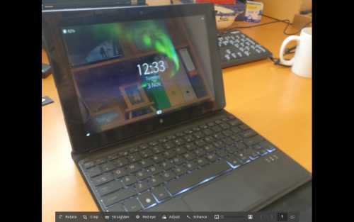

#19
Small update
Downloaded updated droid-config-pinetab and patched (where I thought they went)
and bingo - rebooted sd card
Bluetooth audio worked
Orientation worked
Keyboard worked!
Noted the version had downgraded to 3.3 Rokua ( I had previously upgraded to 3.4)
Tried to run updates but that then broke the system so it would not reboot
Ok - lesson learnt
Will try again - this time with no upgrades
However would like to pass on my thanks
Bluetooth audio /keyboard and orientation make this a candidate to flash now on to the emmc as it looks brilliant - so well done.
If successful will post up some screenies and feedback
Update - non successful. Will have to wait for an updated Alpha as this is sadly beyond me
#20
Any chance of a second Alpha as ...when it worked - worked like a charm
Rotation smooth
Bluetooth connection for audio
Keyboard worked....this in a better state than many other pinetab builds so well done
Feels like a proper tablet at last - looks good and is snappy enough to be (for me ) a daily driver)
but hint hint - a new Alpha Image would be fantastic
