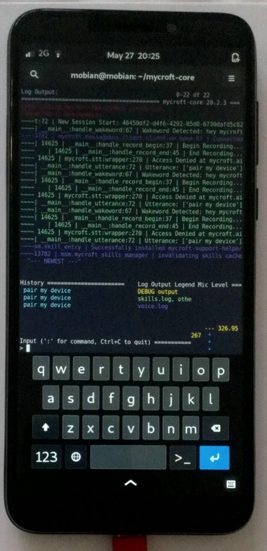

Edit: Voice is detected on a mobian install. Created a mycroft account and paired the device. I guess need the text-to-speech engine (mimic) too but the build is failing at the moment.
Extra: Google is the default speech-to-text service but it can be changed. A less worse option may be IBM Watson.
.jpg   mycroft-pinephone.jpg (Size: 92.29 KB / Downloads: 644)
The mimic1 build was failing due to memory running out as explained here. It would only complete  using one thread/core (make -j1). However, running the mimic command produces no sound (except a low whine) and no error either.
I'm not sure if a local tts engine is necessary though. The docs say it should still work with the remote mimic2 at the server end. More reading required.
Edit: No luck in getting mycroft to speak. It detects "hey mycroft" and even confirms a request to play the news but no sound. I suspect something went wrong in compiling the voices since it completed within about 30mins despite dev posts saying it would take hours. The "make check" passed all tests for mimic though. Running out of ideas so maybe someone else can give it a shot and see if they can get a bit further.
