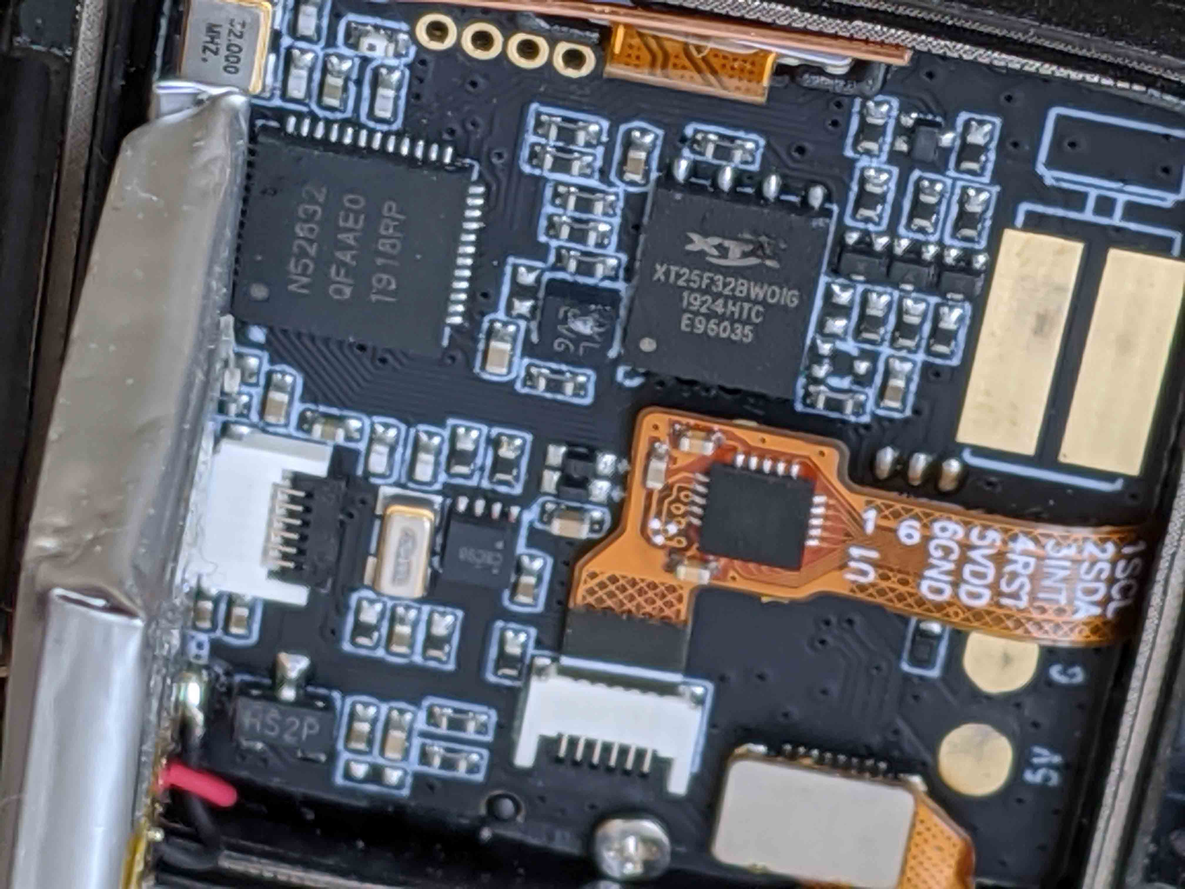

The chip in my watch is very easy to read except for the company logo which is partly blurred.  it says:
XT25F32BWOIG
1924HTC
E96035
Today I rebooted into the bootloader and then waited a full minute.  I then pressed the button once, with no response.  A long press after that got me the Pine64 logo by itself, and then a black screen.

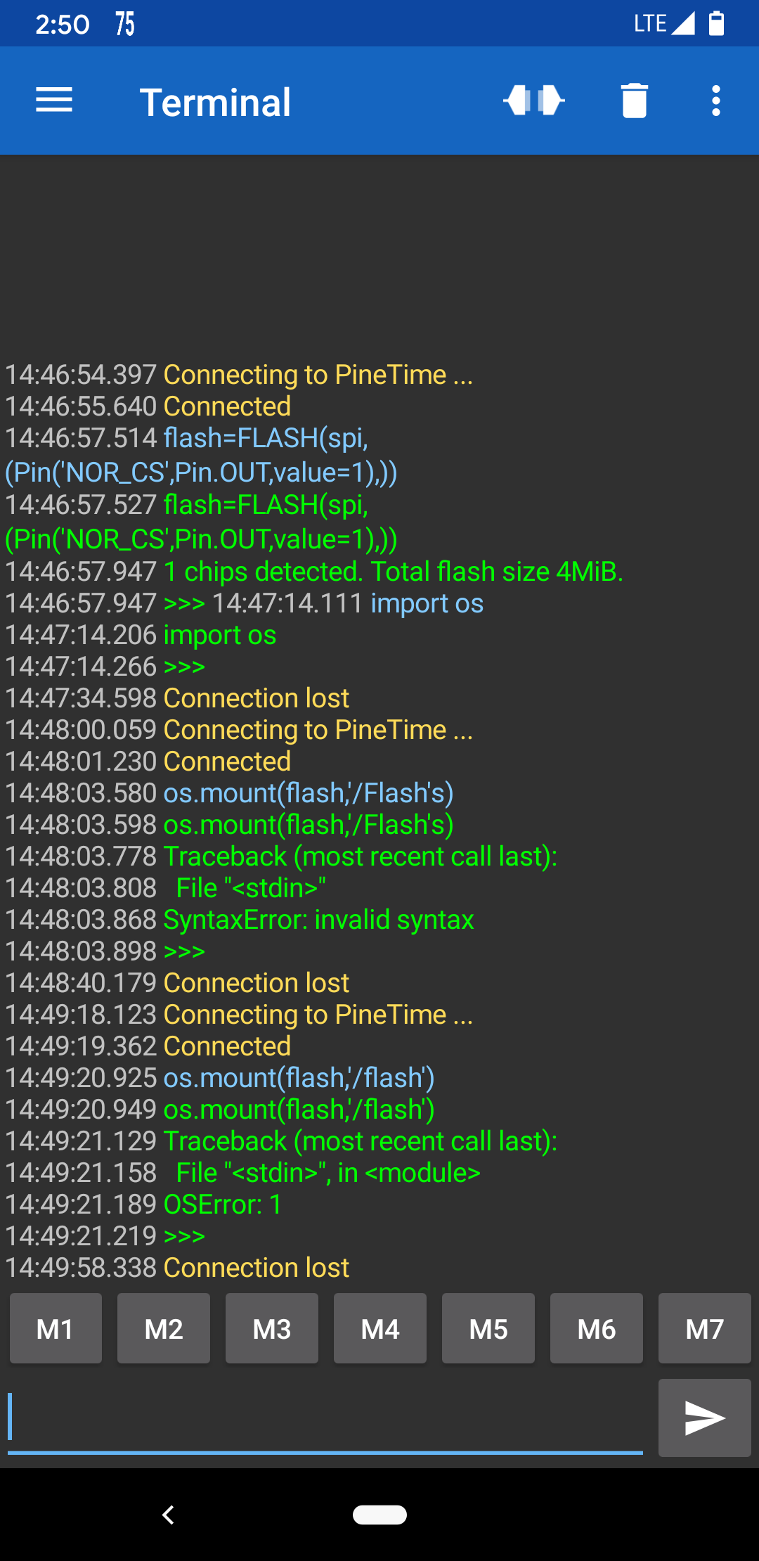

I entered the commands you gave me, it failed on "os.mount(flash,'/flash')" with OSError: 1.  Attached is the screen from Serial Bluetooth Terminal and a picture of the inside of the watch.

(05-27-2020, 03:02 PM)VMMainFrame Wrote: I entered the commands you gave me, it failed on "os.mount(flash,'/flash')" with OSError: 1.  Attached is the screen from Serial Bluetooth Terminal and a picture of the inside of the watch.
Thanks for all the detail. It helps a lot, especially because this isn't what I was expecting.
You might be able to fix it my formatting the external flash. Normally this happens automatically when there is no filesystem but it doesn't seem to be working for you because you are getting the "wrong" error message. Of course the wrong error message is not expected so they could still be something else causing us trouble... but either way we won't know until we try!
The following sequence of commands is pretty long and might not be fun to type via the Android keyboard. Howver if these commands run without error then they will probably fix the problem (e.g. get it booting properly with manual help):
from watch import * flash = FLASH(spi, (Pin('NOR_CS', Pin.OUT, value=1),)) import os os.VfsLfs2.mkfs(flash) os.mount(flash,'/flash') f = open('/flash/main.py', 'w') f.write('''\ import wasp wasp.system.run() ''') f.close()
