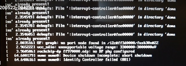

Hi Everyone,
has anyone gotten a Kingston A2000 1TB to work with the NVMe adapter? In the Wiki I saw the 500GB is working.
Mine works perfectly when I connect it to the PBP using a ORICO TCM2-C3 external enclosure but when I attach it to the adapter board the only noticeable thing is a significantly (1 minute) longer boot time ending with the following references to nvme in the output to the screen, maybe it means something to someone:
  nvme nvme0: Device shutdown incomplete; abort shutdown
  nvme nvme0: Identify controller failed (881)
After the extra minute the system boots normally but I the drive is nowhere to be found.
(With the NVMe board installed without the A2000 there is no boot delay.)
I’m running Debian 10. A massive thank you to Daniel for his installer script!!
