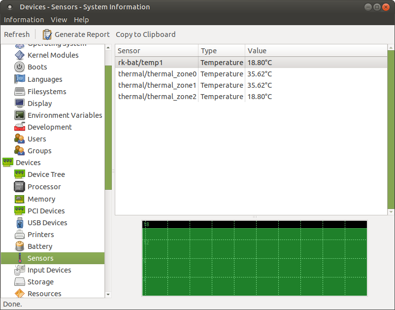

The Mate sensors applet is running now for one week om my Pinebookpro.
Temperature is 19 C. Constant.

This one seems to read the battery temperature, which doesn't seem to have a proper sensor. Try this:
cat /sys/class/thermal/thermal_zone0/temp | echo Zone 0: `awk '{print int($1/1000)}'`
(11-11-2019, 07:14 PM)VoxUnius Wrote: This one seems to read the battery temperature, which doesn't seem to have a proper sensor. Try this:
rock64@pinebookpro:~$ cat /sys/class/thermal/thermal_zone0/temp | echo Zone 0: `awk '{print int($1/1000)}'`
Zone 0: 32

    temp1    label temp1    enabled
Attachments: Hardinfo and Xsonsors
In Hardinfo two sensors are alive.
.png   Hardinfo_sensor_2019-11-12.png (Size: 90.01 KB / Downloads: 753)
.png   Xsensors2019-11-12.png (Size: 10.77 KB / Downloads: 804)
