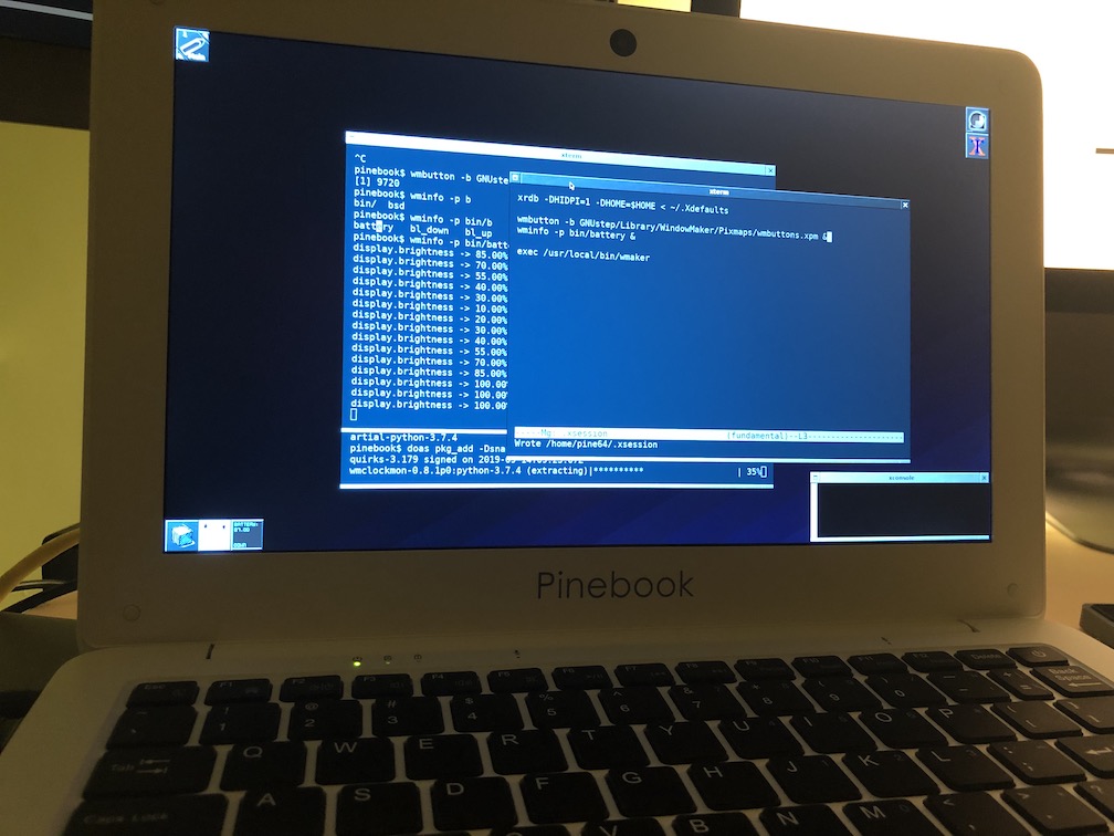

PWM backlight in action:
Looking forward on the openBSD with desktop OS build soon.
