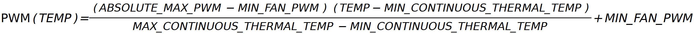

is this correct to change this setting: MAX_FAN_PWM?
I changed it to 150 and the fan is mutch quieter.
or am i wrong and did something fatal? Big Grin

That is one way of limiting without changing too much [Image: shy.png]
The PWM curve by Interpolated method is:
