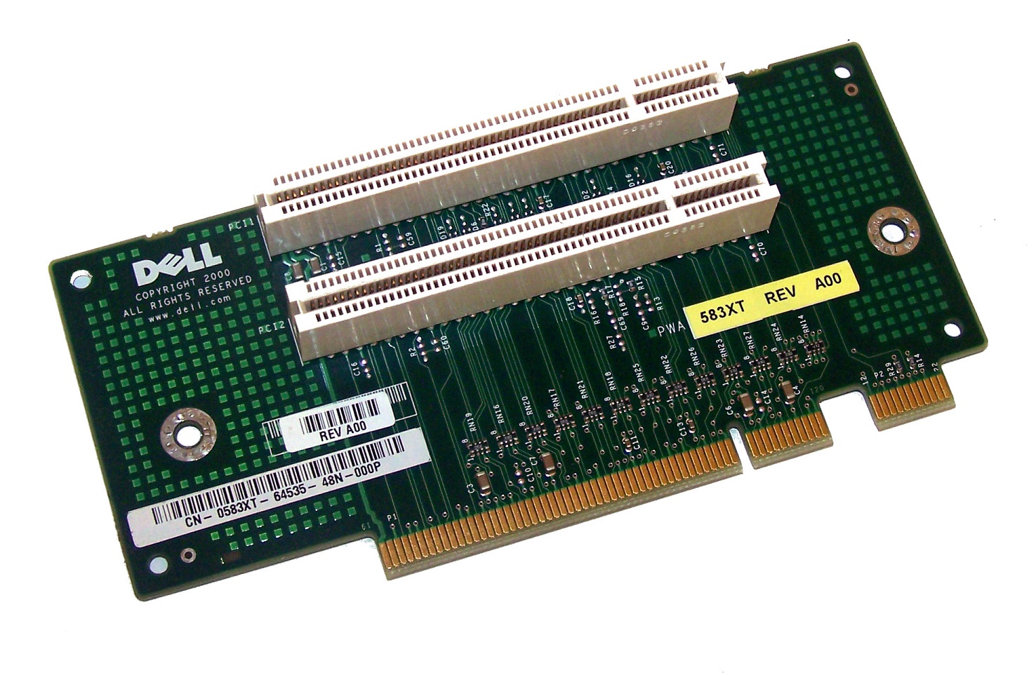

  • In the event that i wanted to add Sopine compute modules, i dont want them at 90 degrees, parrallel to the mainboard to save vertical space. How do i stack them to achieve this (see example of stacker for video cards...which is way too big)
  • does Pine have any sodimm-ddr3 stackers? (i want to stack 2 of these on the sopine baseboard)

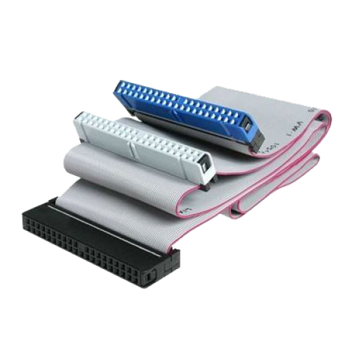

  • could i simply make one up out of something like the old style IDE ribbon? (I realise one cannot use an ide connector...its just to illustrate how the old ribbon cables used to have multiple slots already on them for connecting multiple devices such as hdd, dvd, fdd etc)
