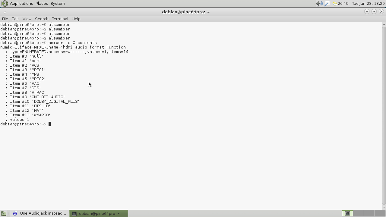

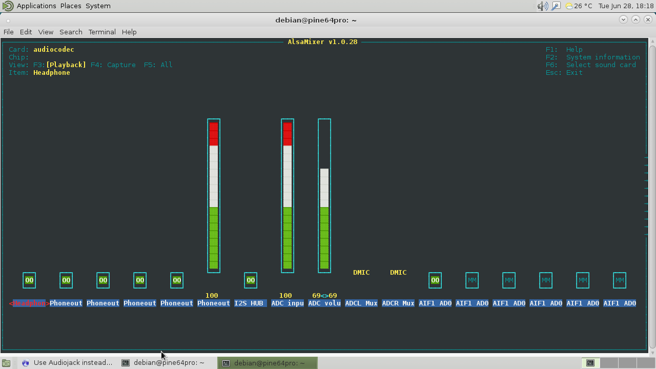

Hello .
I tried everything mentioned in previous post but still did not managed to hear sound from my earphones.
I run Debian Mate (3.10.101 BSP) .
Any idea why I can't hear any sound ?
I also have HDMI-VGA convertor with audio output but no sound at all also on this output.
Is my sound card broken or something I am missing ?
Analog sound card is available, I can set it good but no sound again.
When run alsamixer I un muted headphones but i can not change sound volume it is 00 valued
There is screenshots from my situation.
Any help is appreciated.
