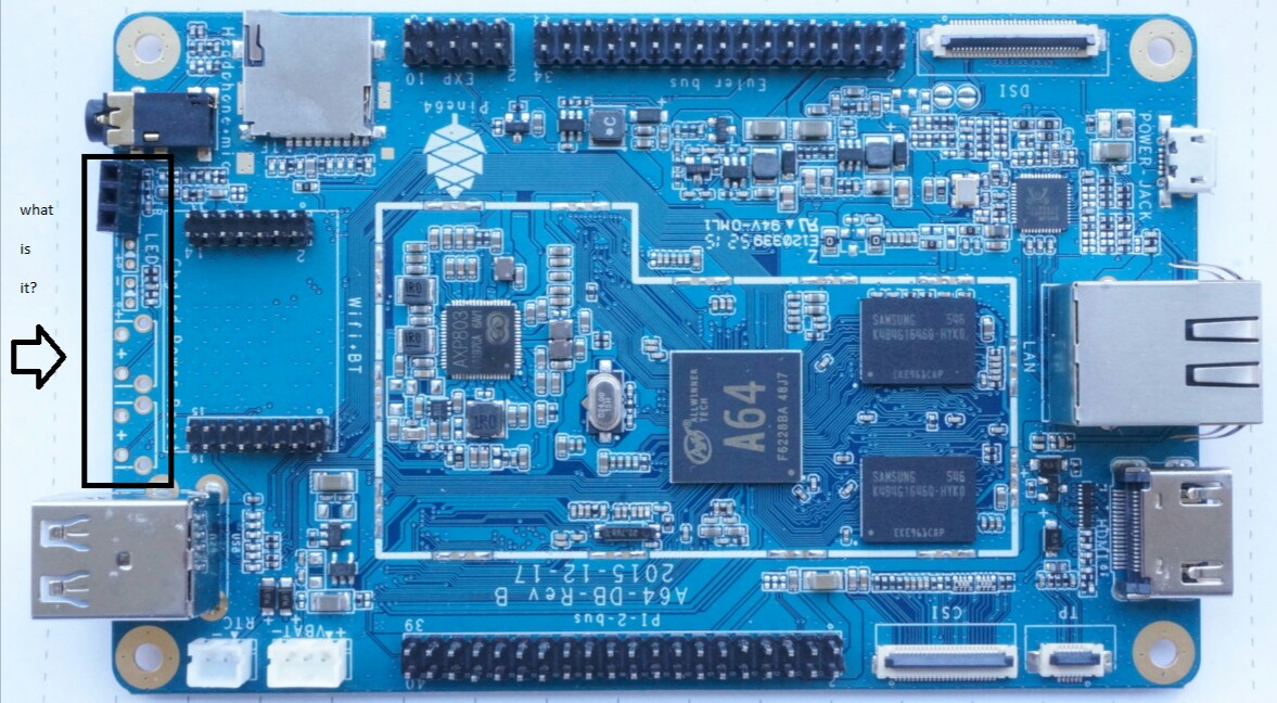

In the attached file below, the space for the switch is on the left, where the arrow is pointing. It will be easy enough to add your own switch if the Pine does not ship with the switch already connected. Perhaps including or not including a switch could be an option on the Backer Survey, if it does not cause any delays to shipping?

Yes, the physical switch where you can turn on / off the Pine.
Currently on the board, there are connections for it, but no physical switch soldered on.
It was supposed to come as a stretch goal reward but there were some people who were negative about having the switch, thus it is now dangling in the air.

I believe the switch that's on the board is actually a momentary contact that's connected to the PMIC.  A short press of the switch when the system is running generates an interrupt to the SoC from the PMIC, causing a soft power off with a graceful system shutdown.  A long hold (16 secs according to the AXP803 PMIC datasheet) forces the PMIC into a powered-off state, where it just shuts off the power to everything.
Pressing the power button when the board is off powers on the PMIC, which powers up all the devices on the board.
