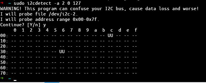

Moving a bit forward: I found the i2c address for the camera module: 0x0c. The DTS description should be complete at this point (I hope).
UPD1: I got bamboozled by dw9714 device, which resides on this bus. It was its address. Investigating further.
UPD2: I have no idea where the frontal camera should reside. According to the schematics, it's on the i2c2 bus, but I can't probe anything other than dw9714 on address 0x0c, and ov5648 on address 0x36. Just for the sake of it, I probed all i2c busses and found nothing.

0x0c is occupied with dw9714, so that's the reason we got an interrupt. 0x36 (back camera) has not responded because it's powered-off, I presume. But the gc02m2 must be powered, because the power-up was done by the probe function of the driver, and yet there is nothing.
Powerdown and reset pins are correct (if the schematics are). I'm at the end of my wits here.
