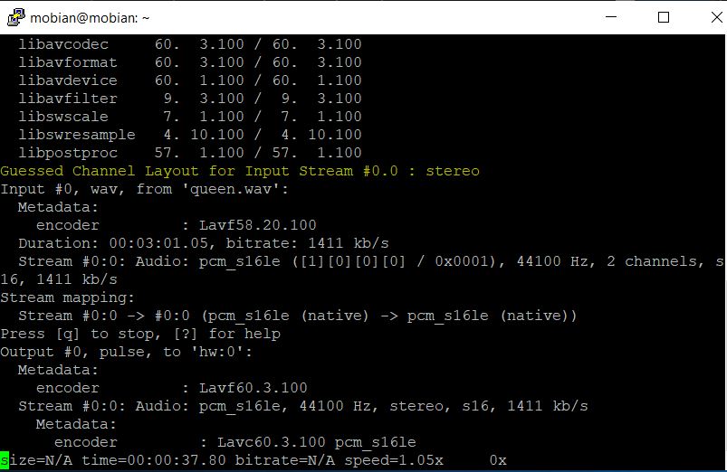

I did as you wrote, but still no sound.

Unfortunately using pulse still doesn't work.
