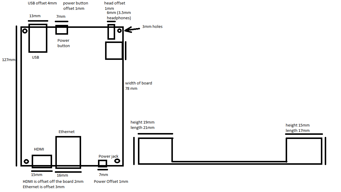

I just got mine today I can have some dimensions up in a little bit. Maybe just a simple drawing as I don't have cad but ill try to be as exact as possible.

(03-30-2016, 03:10 PM)trevor.ribal Wrote: I just got mine today I can have some dimensions up in a little bit.  Maybe just a simple drawing as I don't have cad but ill try to be as exact as possible.
Sent from my D6653 using Tapatalk
That would be great Smile Havent recieved my pine yet, and would love to get my casing of to printing as soon as possible Smile
very simple but i hope you get the idea. if you need more info just let me know. Im on the lookout for some decent enclosures too.
(03-30-2016, 04:44 PM)rebel1988us Wrote: very simple but i hope you get the idea. if you need more info just let me know. Im on the lookout for some decent enclosures too.
Thank you very much. This will help me alot. Only one thing I'm missing. The placement from the corner nd the space between the parts Wink
Or maby I just didnt understand the drawing completely.

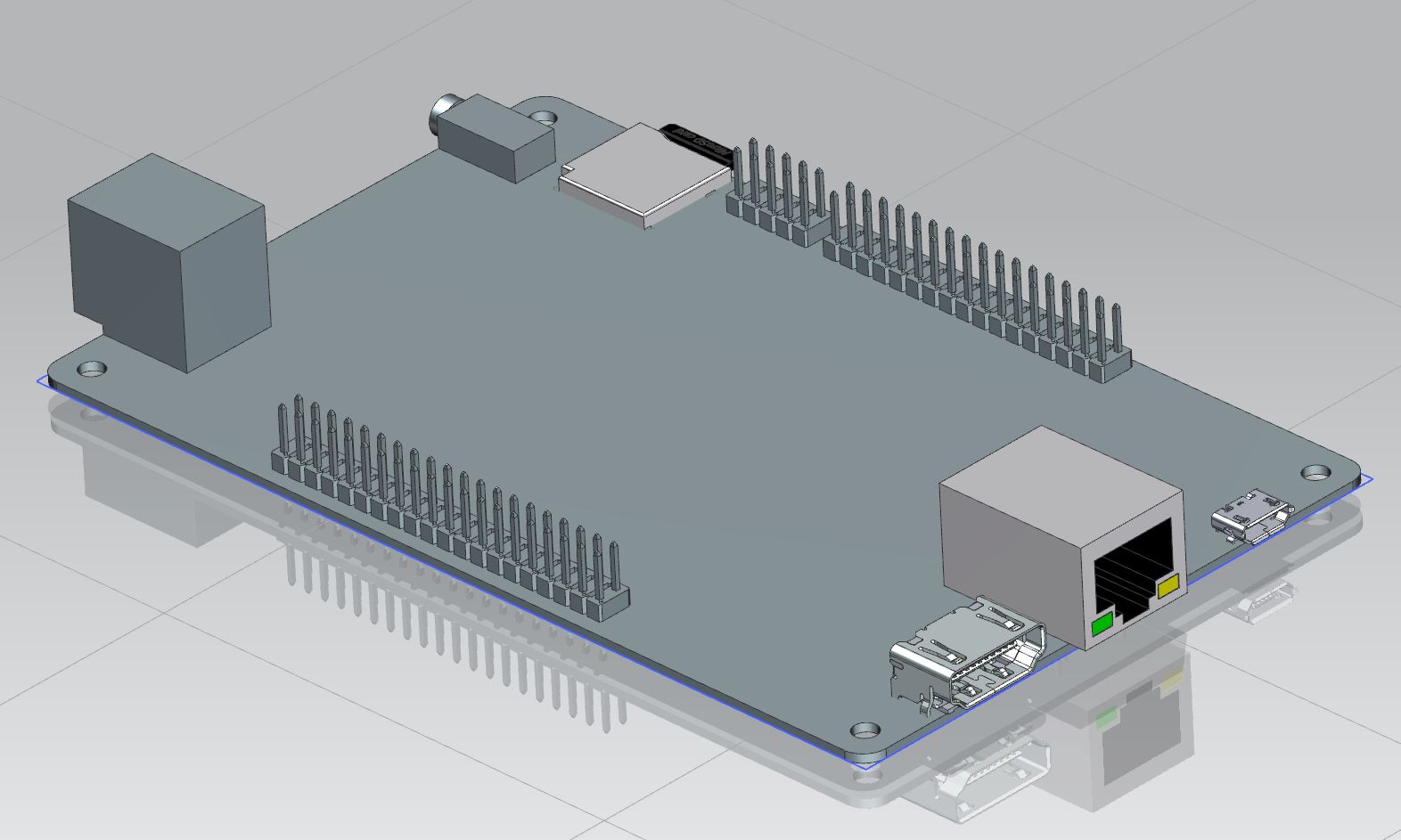

If it helps anyone I threw together a rough CAD model, it's located here (see photo in attachment):
http://www.3dcontentcentral.com/parts/do...alogid=171
This is all based on measurements I took off my board, so don't get mad if you use it and your holes don't line up or whatever, but I tried to be as accurate as possible.  Let me know if you see any corrections needed.
Enjoy.

(04-13-2016, 09:29 AM)w1ntermute0 Wrote: If it helps anyone I threw together a rough CAD model, it's located here (see photo in attachment):
Enjoy.
wm
It would be nice to have the power an reset buttons as well. Other than that. Thanks for the work Wink
