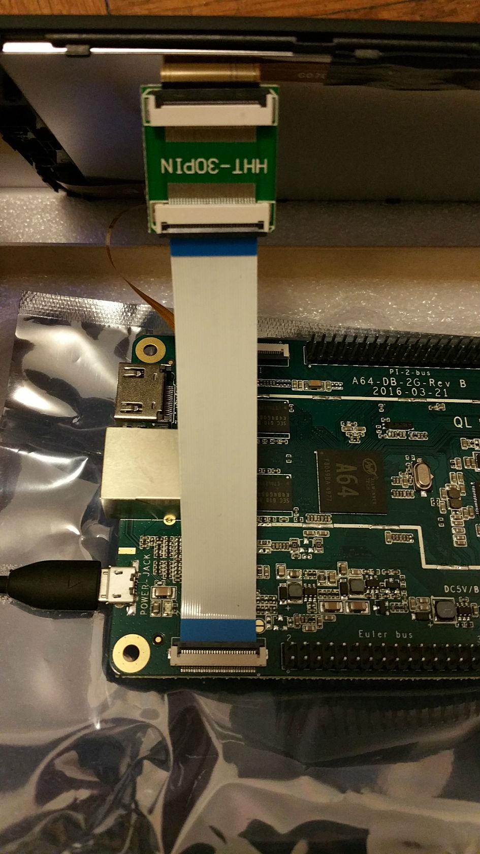

Hi All,
I bought the 7" LCD touch screen with my order.  I believe I have connected it correctly, when I power on the pine board the screen does not turn on.
The HDMI port is working and I was able to boot into Ubuntu, so the board itself is working.
Any ideas what it might be?  Maybe the screen is DOA....
There is currently only one image that supports the touchscreen: This one
Burn it using Phoenix card - remember to set 'startup!' Before burning. See if it works.
[url=http://files.pine64.org/os/android/android-ver5.1.1-lcd-version-20160419-pine64-phoenixCard.zip][/url]
(06-02-2016, 06:45 PM)Luke Wrote: There is currently only one image that supports the touchscreen: This one
Still trying to figure out how to get this image to work. I wrote it to the card with PhoenixCard in startup mode. The Pine starts and screen comes on with the A64 android screen but just hangs there and never does anything else.
Thanks Luke, the image activated the LCD screen as it should.
Mine did not boot into the OS the first time either. First try it was stuck at the AllWinner logo then it shut off after a couple of min. Second try, it got passed the AW logo and to the pine a64 logo, then the screen got brighter and turned all white with thin black lines. I left it like that for a couple of min, nothing happened so I rebooted it. Third boot, the OS finally booted.
HTH Dup.
(06-02-2016, 09:19 PM)Dnode Wrote: Thanks Luke, the image activated the LCD screen as it should.
HTH Dup.
Thanks Dnode. Have tried to boot it about 10 times now. Same thing each time. I even pulled the wifi board off as well just to try to boot without it as well, still nothing. Just keeps booting up stuck to the logo. Frustrating.
