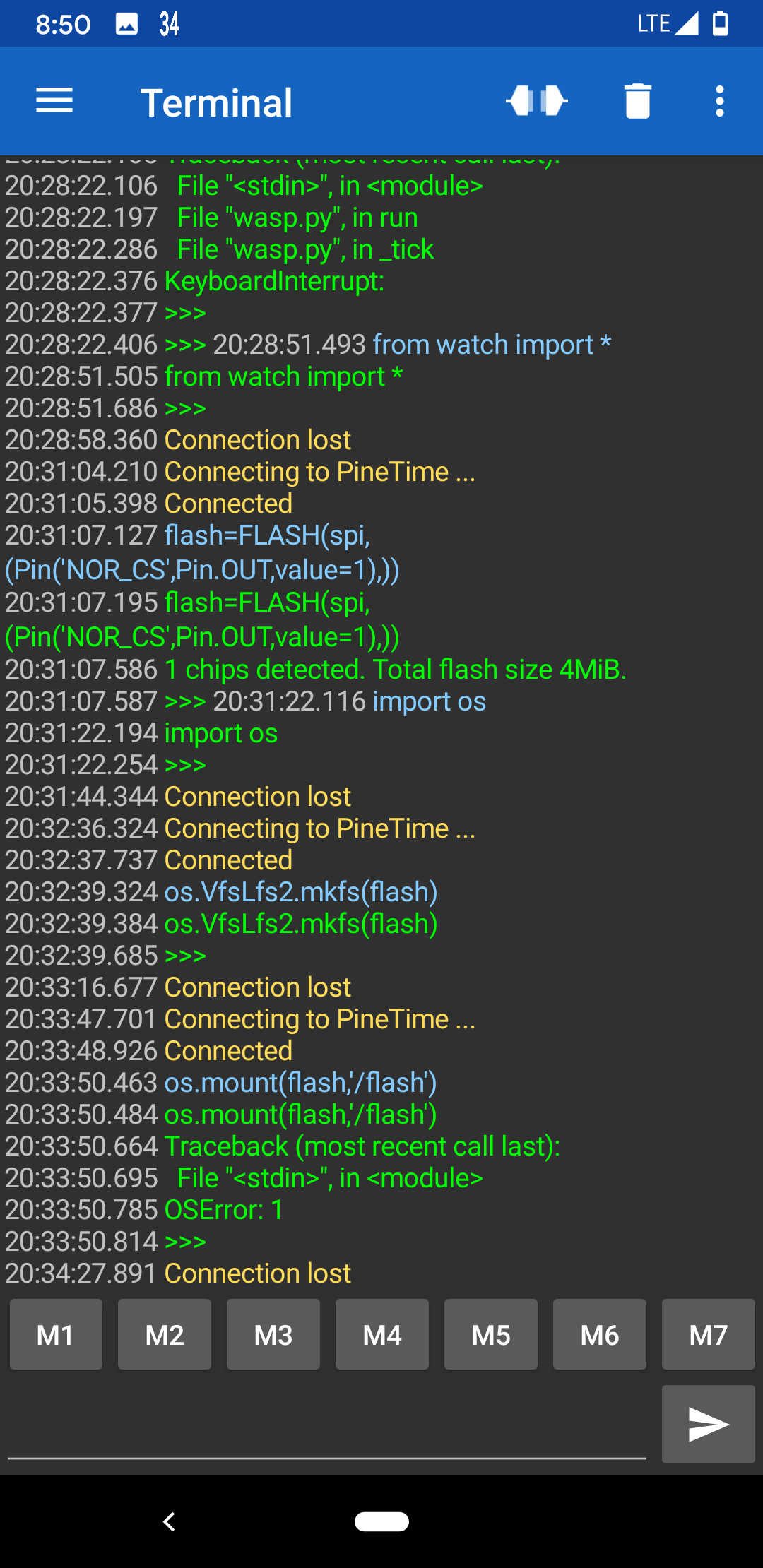

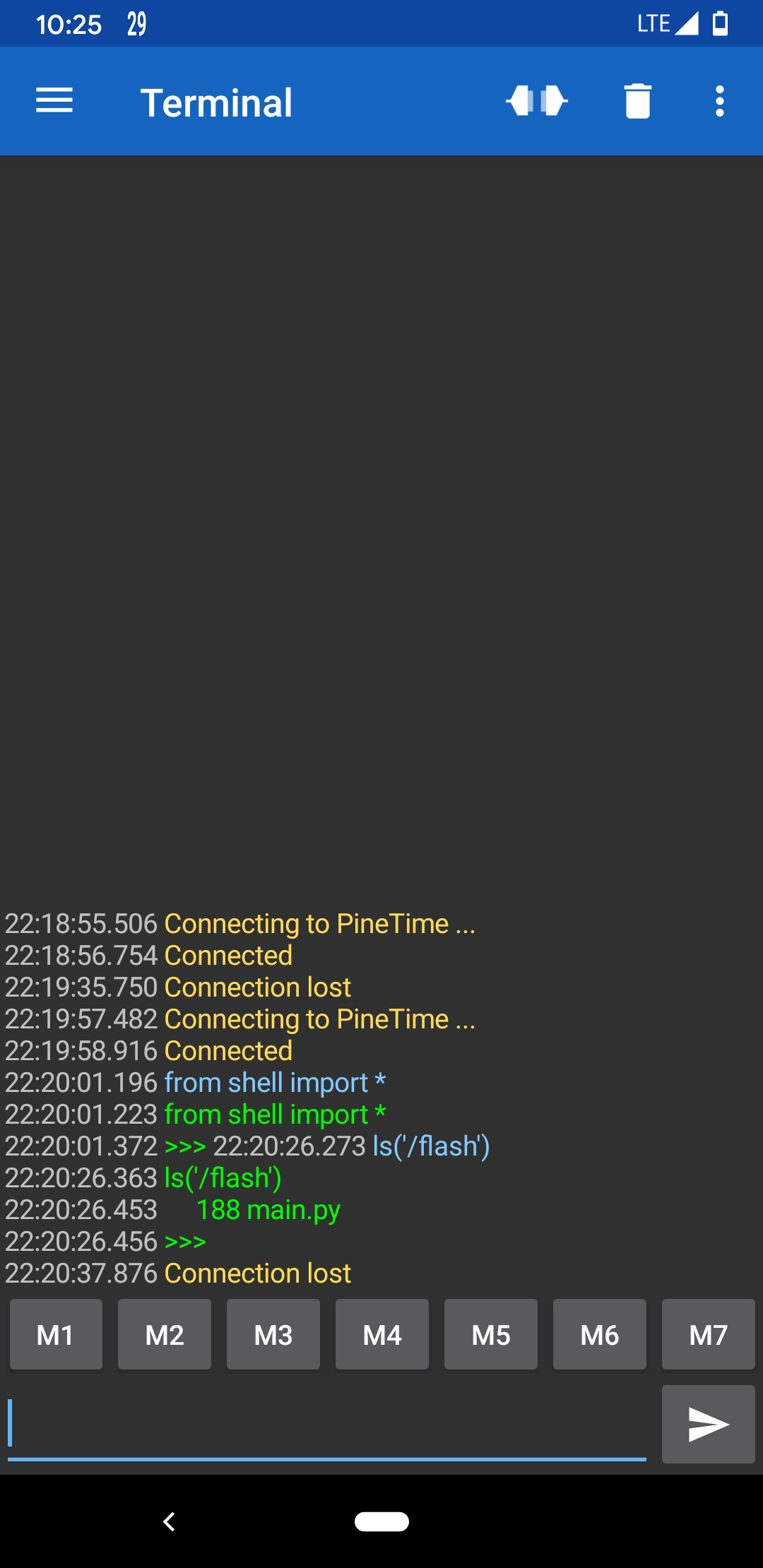

.png   Pinetime-log2.png (Size: 330.11 KB / Downloads: 911)
.png   Pinetime-log3.png (Size: 125.89 KB / Downloads: 912)
.png   Pinetime-log4.png (Size: 271.05 KB / Downloads: 867)
Daniel,
I typed in the commands you gave me and it failed the same place as yesterday.  I then tried a few things and found that the /flash filesystem seems to already exist, and it has a file in it.  I also found if I umount it then it will mount without error.  See the attached screenshots.
Hugh

(05-28-2020, 09:01 PM)VMMainFrame Wrote: Daniel,
Hugh
Strange... so in summary everything appears to work perfectly! Thus it is *very* strange the watch doesn't show the UI automatically at boot.
I guess as a final check you should use cat('/flash/main.py') to make sure that the contents of main.py are correct. Perhaps you could also confirm that you are not acidentally booting into safe mode are you (if you have the button pressed when the pine cone disappears to the final time then the watch will enter safe mode and skip the startup file).
Anyhow... either way, thanks for your contributions. I've already improved the bootloader based on your feedback and today I filed another issue based on our conversation (since it would be so much better if safe-mode was obvious and I didn't have to ask the last question): https://github.com/daniel-thompson/wasp-os/issues/29 .

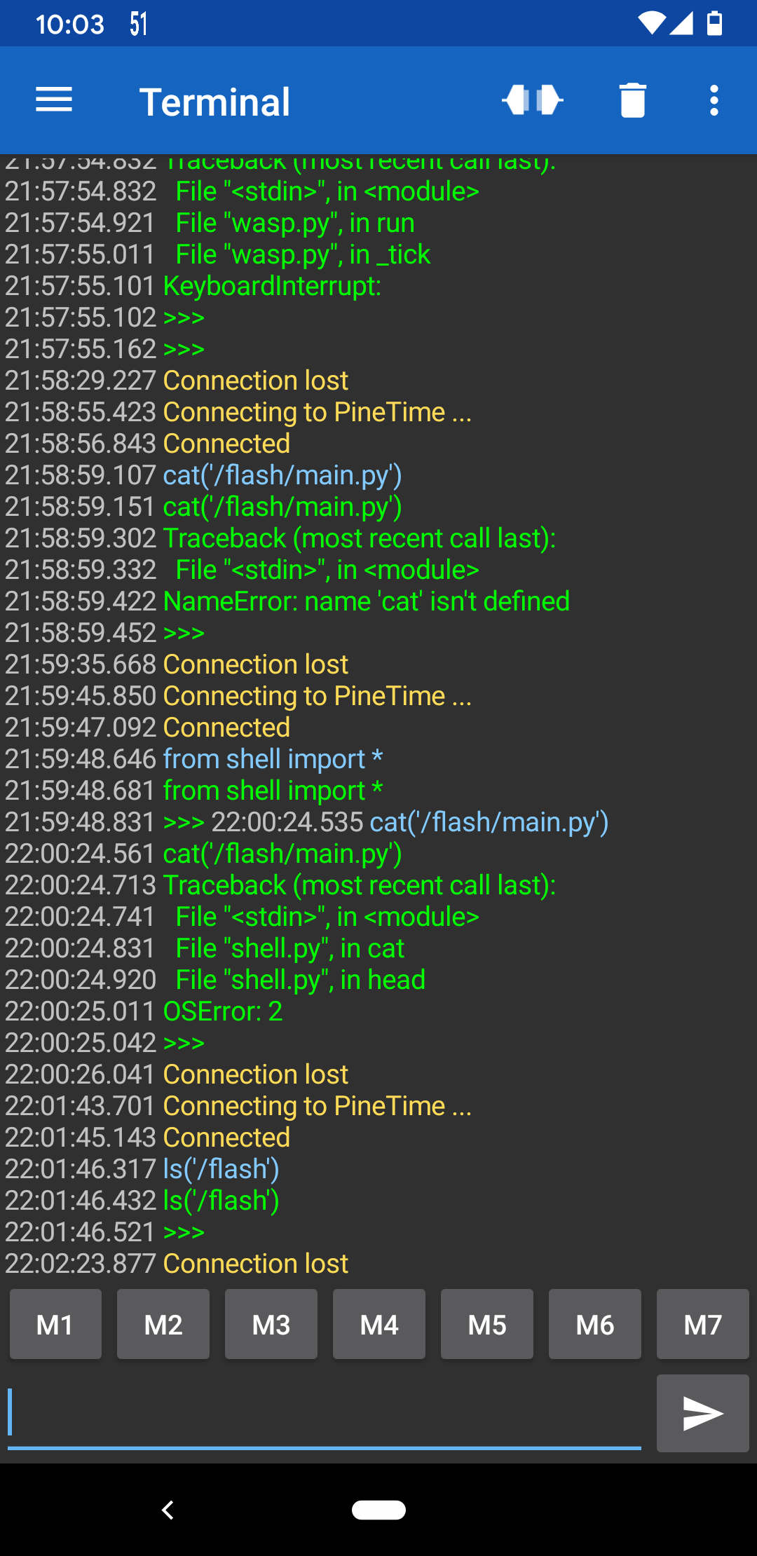

I issued the cat command and an ls command and the results are confusing, considering the information I previously provided.
.png   Pinetime-log5.png (Size: 320.82 KB / Downloads: 930)
Yes, confusing indeed.
I think to get to the bottom of this I think I'll need to change to the code to boot.py to get some more information out. IIRC you were using the 0.2 release... are you compiling yourself or working just with the binary release? Just wondered if I should share patches or .zip file?
