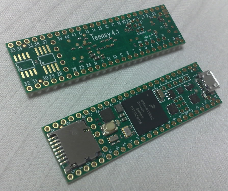

The Teensy 4.1 boards I've ordered arrived a couple of weeks ago, attached is a picture of them in person. Smile  In the meantime, I've been busy with debugging some U-Boot and ASoC issues on the PineBook Pro, which resulted in not much time being spent on making the Teensy 4.1 boards do something.  However, that doesn't mean that the boards will become abandoned. Cool
What I've accomplished so far is to get the TinyUSB's USB mass storage example compiled, although I haven't flashed it to a Teensy 4.1 yet.

(07-07-2021, 08:08 PM)dsimic Wrote: The Teensy 4.1 boards I've ordered arrived a couple of weeks ago, attached is a picture of them in person. Smile
I haven't tried to get another Teensy board yet, the sources I went to originally have now dried up. I also haven't had much time to work on one in any case.
I still have the Pi Pico for now, which should be good enough for some initial experiments. I'm sure there will already be some dev effort in this space, so shouldn't entirely be from scratch.
