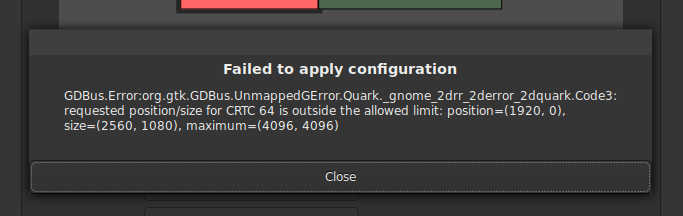

Screen resolution gets all weird.
Added screenshot of PBP standard resolution, and another where the custom resolution has been added. Does anyone understand why this happens?

If I do choose to set the resolution I get the following error (cant copy it, have uploaded a screenshot of the dialog Screen3).
After that the screen goes dark, and if I go into the display settings dialog again the monitor is "flipped" off, and after turning it on again on the panel in the dialog I now have a bunch of sub 1920x1080 resolutions which were not there before (only the 1920x1080). I tried adding the mode with xrandr with 60hz, but it made no difference.
I also tried (although don't know ifts correct) setting the mode via terminal:
$ sudo xrandr --output "DP-1" --mode "2560x1080_60.00" --rotate normal
xrandr: screen cannot be larger than 4096x4096 (desired size 4480x1080)
Last time I checked 4096x4096 is smaller than 2560x1080 Smile so I have no idea what thats about.
4480x1080 is completely wrong resolution for my screen, but none the less I tried setting it. This actually adds the screen as "normal" and not counterclockwise, but gives me error of "screen4" attached file.
If anyone else has any ideas on how to proceed, I'm all ears.
