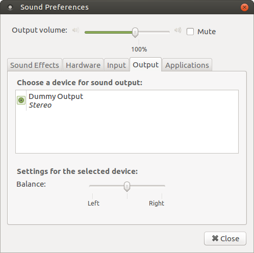

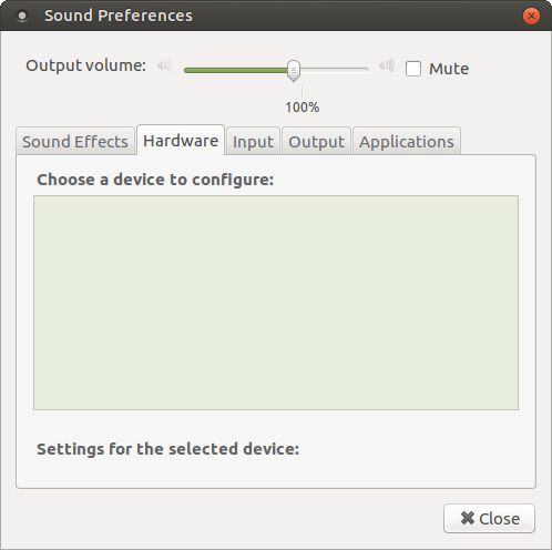

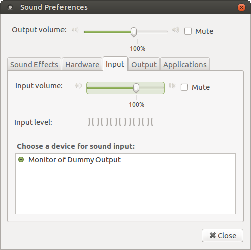

Wizzard... I reported that in the IRC last night (and you can see some screenshots attached of what the sound preferences looks like when it's not working OOTB).  I thought it was package related, but it looks like it wasn't... it seems the group change I made didn't take effect until I rebooted. Run "sudo usermod -aG audio pine64" and reboot, and your sound will work again Wink
