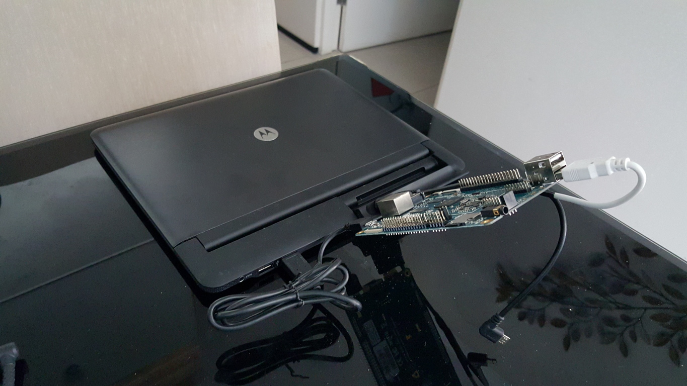

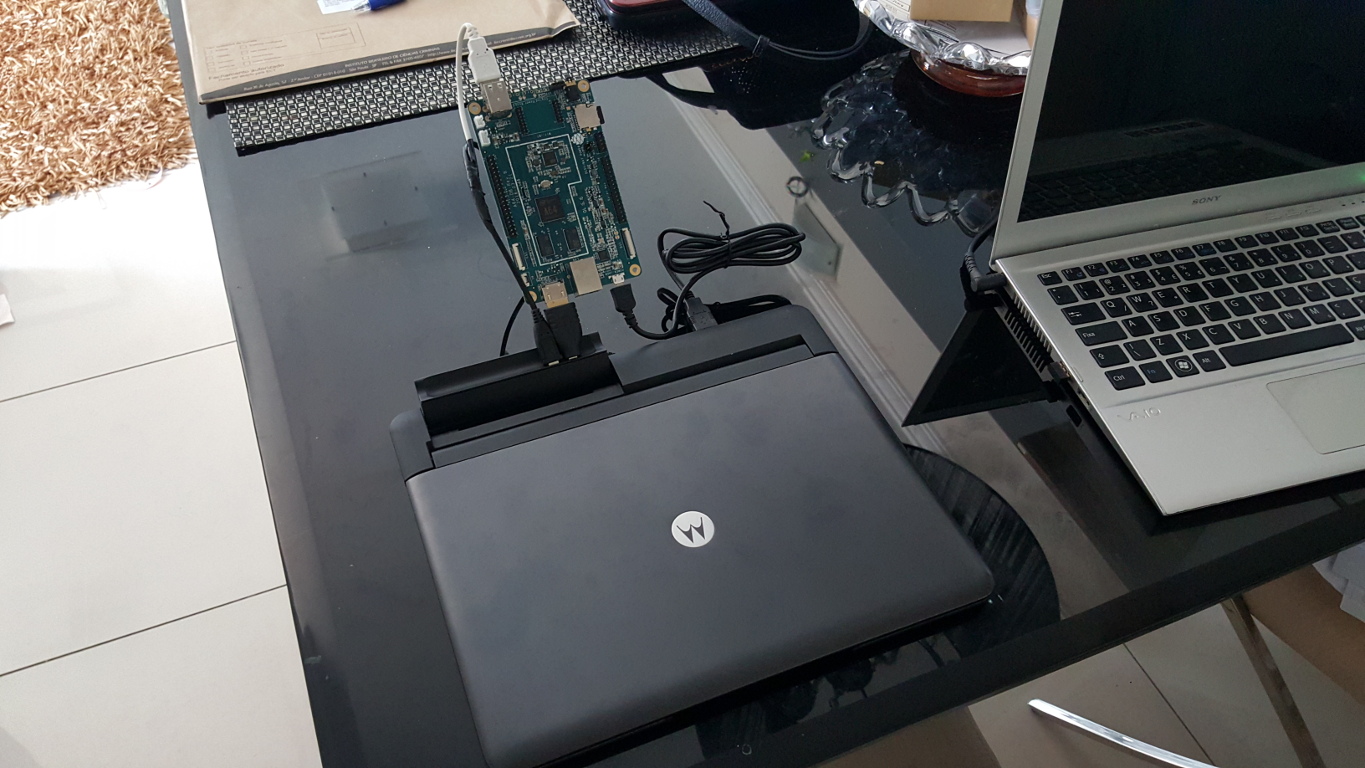

Ps.: I would like to share my experience. I am using the Pine64 1GB + Remix OS, on a Motorola Atrix Lapdock. I bought the lapdock on the web for less than US$20, and with it I have a 720p 11" screen, USB HUB, Speakers, Trackpad, Keyboard, Battery Pack and a form factor of a very slim notebook. I surely recommend it for anyone that fools around with single board computers. ;-)
