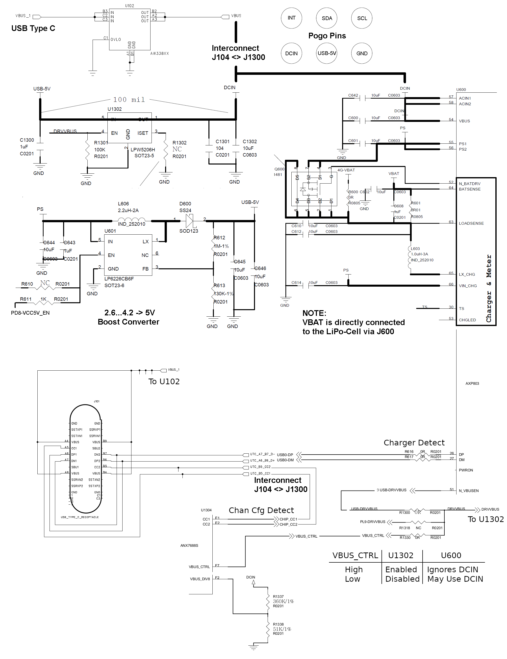

Pogo pins power clarification - reading schematics

Added USB detection + power control to the bottom of @scholbert's collage.
This shows where the ANX7688 looks at CC1/CC2 and DCIN for USB C channel configuration detection, while the AXP803 looks at DP/DM for (dumb) charger detection. Shows where the ANX7688 can decide to turn on VBUS_CTRL, which affects both the LPW5206 and the PMIC.
Even if the ANX7688 says it's ok to use DCIN, the PMIC can still decide not to use it for other reasons.
Thanks @smaeul for explaining how this works!

(03-23-2021, 08:39 PM)bokomaru Wrote: Added USB detection + power control to the bottom of @scholbert's collage.

Haha no reason to be sorry, no obligation @scholbert. I liked your idea of the condensed picture, and I hope it helps others to find the right parts to look at to understand things more easily!
I don't think I have many questions left, but at least one thing is still on my mind: What happened with @GregH's phone here?
(03-01-2021, 12:24 AM)GregH Wrote: * I then attached the USB device without supplying power to DCIN. USB device worked fine. Good.
* I then supplied +5V to DCIN. Good new? No magic smoke! Bad news? No charging.
My guess: There is no charging because VBUS_CTRL is high, which means the PMIC ignores its DCIN input. But, there are now two power sources (5 V regulators) connected together at DCIN like this?
Battery -> PS -> LP6226 -> USB-5V -> LPW5206                                             \                                               --> DCIN -> USB C port -> USB device                                             / External 5 V source -> pogo pin -----------
Should that be avoided? Similar to how we should avoid connecting 5 V to DCIN while a charger is connected to the USB C port?
@GregH's phone didn't catch on fire. Is that "luck", or is there something about the design that makes this ok or "safe"?
(Note: Now I understand that this doesn't create a "loop" inside the phone, because the PMIC ignores DCIN while the LPW5206 is enabled)

My guess about why GregH's phone didn't catch on fire would be that the output of LPW5206 was at exactly 5 V, while the external 5 V source was actually slightly below 5 V.  As a result, the output of LPW5206 was able to "beat" the external source, while the external source had some kind of protection (most probably an isolation diode) that prevented power from feeding into it.
Edit: Even if the external 5 V source was at exactly 5 V or even slightly higher, so the output of LPW5206 was unable to "beat" it, our beloved D600 diode prevented the external source from reaching the LP6226 or PS.  However, all this should be avoided, IMHO.

(03-14-2021, 11:30 AM)bokomaru Wrote: I'll only attack one topic today in this post, and I think @smaeul just beat me to it :-P
(03-14-2021, 07:42 AM)megous Wrote: - USB-5V seems like it should always be 5V if PS-5V is enabled and if it has some other voltage when PS-5V is disabled, it's only because there's some remaining charge on the capacitors, or some current going in the reverse direction via U1302 via internal N-MOSFET body diode (see https://megous.com/dl/tmp/06d11858b841c503.png - there's a parasitic diode between S-D in that direction) You're not supposed to rely on USB-5V in this case, when PS-5V is off (another diode on the PS-5V output prevents backfeeding of power through PS-5V)
I think I can show that the "other" voltage on USB-5V is neither due to a capacitor nor reverse current through U1302. (It really is battery voltage coming from PS across D600)
Phone powered on, no external power attached. Measure USB-5V to be ~ 3.9 V. Connect a 1 k ohm resistor (brown black red) between USB-5V and GND, to draw a few mA of current. Measure voltage at DCIN to be 0 V. Measure voltage at USB-5V to be ~ 3.7 V.
It's not "residual capacitance", because I'm drawing current, and the voltage is constant w/o decaying, even over minutes of time while drawing a few mA of current.
It's not "reverse current" through U1302, because the "reverse source" side of U1302 would be its VOUT, which is the Pinephone's DCIN, which I measured to be 0 V.
So I think that when the LP6226 is disabled, current really does just flow from PS through D600 to USB-5V. Even if that wasn't totally "intended", I don't see why it would be an issue for a pogo expansion board to draw current from USB-5V even while the LP6226 is disabled, since PS is still the source in either case.
Right, I didn't notice the inductor.
Actually, the LPW5206 has no parasitic body diode, as specified on page 1 of the datasheet.  Here's a quotation:
Quote:A built-in charge pump is used to drive the N-Channel MOSFET that is free of parasitic body diode to eliminate any reversed current flow across the switch when it is powered off.

Original questions from the 1st post, with answers:
  1. Is that a good read? Did I get it wrong?
    Pretty much a good read, yes. There were other aspects and details that got pointed out, though.
  2. Did I get the pinout right? Why are PIN1 and PIN2 in the middle?
    No, DCIN and USB-5V were swapped. The pins were probably numbered in some arbitrary order in the logical schematic, and then moved around into some other arbitrary order for the physical layout.
  3. Does USB-5V/PIN5/VBUS provide a 5V output up to 500 mA?
    Yes, but we didn't come up with a firm answer on what the current limit actually is, or what happens when you exceed the limit.
  4. Is DCIN/PIN1/VBAT a 5V input for powering the device and charging the battery?
    Yes. It can also be an output. You need to be careful, though. See the wiki page warnings.
  5. What happens if you connect a 5V input to DCIN/PIN1/VBAT and to the USB-C connector at the same time? Would that short together two power sources?
    Yes, we think so.
  6. "VBAT, which connects to the battery voltage" would make me think that pogo PIN1 basically connects to the positive battery terminal VBAT. Not true though, right?
    Right.
