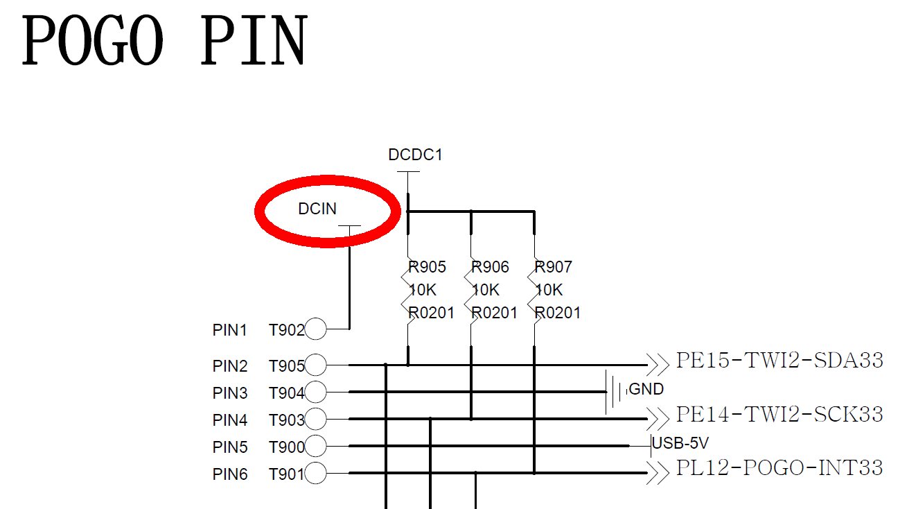

Looking at schematics and datasheets...
I don't see the pogo pins labeled on the physical mainboard. If I put together the component placement drawing (or the pinout on the wiki) with the schematics, I suppose the pinout goes like this.
PIN6 PIN2 PIN4
PIN5 PIN1 PIN3
or
INT    SDA  SCL
USB-5V DCIN GND
Now...

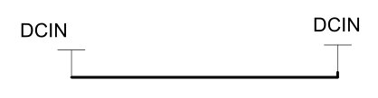

DCIN: DCIN from J1300 (40PIN) on the mainboard connects to VBUS on J101 (40PIN) on the USB-C small board, which goes to VBUS on J101 (USB_TYPE_C_RECEPTACLE). So DCIN would be the 5V input from a USB-C charger. It goes to ACIN1/ACIN2/VBUS on U600 (AXP803 PMIC). If ACIN/ACIN2/VBUS is available, the AXP803 uses that as the power source and charges the battery. DCIN also goes to pogo PIN1.
USB-5V: PS (IPSOUT? Power Supply?) comes from U600 (AXP803 PMIC) and feeds L606 (LP6226CB6F boost converter), to make USB-5V. USB-5V arrives at pogo PIN5.
DCIN and USB-5V loop: Don't know exactly how this works, but if DRVVBUS is enbled, USB-5V actually provides DCIN through U1302 (LPW5206H USB power loading switch). So we can provide a 5V output for a USB device on the USB-C small board J101 (USB_TYPE_C_RECEPTACLE).
VBAT: In schematics, VBAT comes from J600 (the battery connector). Pretty sure it never touches pogo PIN1/DCIN nor pogo PIN5/USB-5V. The wiki calls pogo PIN1 "VBAT".

  2. Did I get the pinout right? Why are PIN1 and PIN2 in the middle?
  3. Does USB-5V/PIN5/VBUS provide a 5V output up to 500 mA?
  4. Is DCIN/PIN1/VBAT a 5V input for powering the device and charging the battery?
  5. What happens if you connect a 5V input to DCIN/PIN1/VBAT and to the USB-C connector at the same time? Would that short together two power sources?

I'm in doubt that the schematic gives us the correct information... and the comments i gave in my last post were based on these.
I made some measurements myself... though i try prevent a complete disassembly right now.
Checked the following connections:
USB Type-C cable connection (DCIN) to Pogo-Pins 5/1 (wiki names VBUS/VBAT) -> no direct connection -> conclusion: the schematic is wrong at this point no DCIN at Pogo Pin1 (T902)
Battery Connector VBAT (J600, Pin4) to Pogo-Pins 5/1 (wiki names VBUS/VBAT) -> no direct connection -> conclusion: no direct connection to the battery at VBAT Pogo Pin1 (T902)
To finalize here:
Pogo Pin1 (wiki name VBAT) reflects the Battery Voltage (on my device: Battery Voltage - 0.1V, as i did a direct measurement on the battery and then at the pin it to compare). I realize a short ramp up to 4.8V but then drops back to 3.9V.
It is not clear to which exact net this pin is connected. It's definetely not DCIN... nor is it VBAT (to be clear here: net names taken from the schematic).
Pogo Pin5 (wiki name VBUS) reflects the Power Supply Voltage. If it's plugged, i measure 5V, if not connected -> 0V.
Not sure about the schematic net entry about USB-5V here... i'm in doubt again that this is correct.

Going by schematics, it's true that the same DCIN net doesn't actually go _all_ the way to the USB C connector. On the USB-C small board, there's one component U102, which is an AW338XX "load switch", which is I guess supposed to break the connection if there's too much current or voltage. Maybe the AW338XX doesn't behave like a zero resistance wire for whatever signal our multimeters use for checking connectivity?

Another thing i realized by having a closer look at the schematic again (and a comparison with the Pine A64+ schematic as well).
It seems to me that there are two different DCIN nets with barely the same name... see my screenshots attached.
My next guess is there could be net names like "DCIN" and "DCIN ".
The red circles may point the same nets then... hope you know what i mean.

(01-08-2021, 04:59 AM)scholbert Wrote: Another thing i realized by having a closer look at the schematic again (and a comparison with the Pine A64+ schematic as well).
Wow, good find!
I did wonder before why there was a separate drawing connecting DCIN to itself (screenshot attached). Now I see that one is "DCIN" and the other is "DCIN ".
Now I'm not sure if they're really supposed to be one net, or actually two isolated nets. But if they _are_ separated, we have an idea where or why. Neat!

For extra credit, I checked the top row of pogo pins against the adjacent resistors. R907 has connectivity with the top-left pogo pin. R905 has connectivity with the top-middle pogo pin. R906 has connectivity with the top-right pogo pin.

Wrong!
I made a bad assumption that the columns would line up. So I had PIN1 and PIN5 mixed up.
If you think about it, that makes sense given the several voltage measurements I made earlier. The bottom-left pin was always 0.2 V below my power supply, no matter what. That's because this pin connects right up to the power supply. The 0.2 V discrepancy is going to be due to resistance, or a voltage drop across U102, or even differences between the meter on my variable supply vs my multimeter.
I'm also renaming from SCL to SCK to match the name in the schematics.
The confirmed pinout is this:
PIN6 PIN2 PIN4
PIN1 PIN5 PIN3
INT  SDA    SCK
DCIN USB-5V GND
Why are the pins numbered in this order? (PIN6, PIN2, PIN4, PIN1, PIN5, PIN3) Good question. Probably, the logical names for schematics were picked before the physical layout was done. So they got rearranged into the order that made physical sense.

This pin is called DCIN in the schematics!
I now have evidence that it would be safe to provide power _to_ this pin as an _input_ to the PinePhone, under one condition: You don't provide power to the USB C connector simultaneously.
It seems like it would also be OK to use power _from_ this pin as an _output_ from the PinePhone, if one of two conditions are true. 1) A 5 V power supply is connected to DCIN at the USB C connector, which means you're pulling power directly from your external USB supply, or 2) the PinePhone is driving DCIN from USB-5V via U1302, which means you're ultimately pulling power from the battery, possibly boosted up to 5 V. I don't know how much current you could draw safely.
Wiki:
Quote:The second power pin is VBAT, which connects to the battery voltage.
This pin does _not_ connect directly to the battery. It's actually called USB-5V in the schematics!
This pin is at battery voltage _sometimes_, depending on what power sources are connected, and the operation of the PMIC and external regulators. Sometimes, this pin is at 5 V.
It seems like it would be OK to use power _from_ this pin as an _output_ from the PinePhone. I don't know how much current you could draw safely.

My findings are that you could use _either_ of PIN1 (bottom-left) or PIN5 (bottom-middle) as a power output from the PinePhone, and you could use _only_ PIN1 (bottom-left) as a power input to the PinePhone. But only if certain conditions are met, which I already listed. And how much current you could draw or provide is unclear.

ACIN and VBUS are tied together.
(01-08-2021, 08:38 PM)bokomaru Wrote: Now I'm not sure if they're really supposed to be one net, or actually two isolated nets.
There is only one, connected DCIN net.
