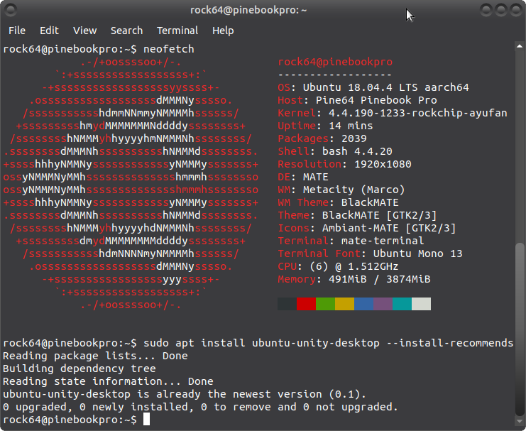

Ok strange situation here that I don't know how to fix. I've done everything I'm supposed to do (I believe). I now have a Unity login screen and a Mate desktop. Is there some step I've forgotten or overlooked. BTW, I have right click and tap to select the way it is but want Unity more.
.png   Screenshot at 2020-01-31 18-56-58.png (Size: 112.29 KB / Downloads: 896)
On the log in screen, there should be a button to the right of your user name (it looks like a circle). If you click on it you will be presented with the available desktop environments to use. Selecting Unity (default) will take you into the Unity desktop.

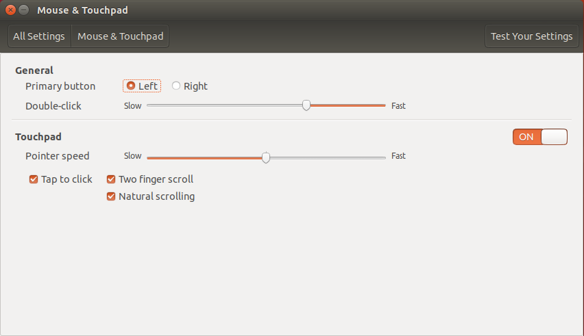

I've gotten tap to click working.
Run:
sudo apt install xserver-xorg-input-synaptics
Now install Unity Tweak Tool from the Software app and restart.
Go to system settings and you'll have tap to select now
.png   Screenshot from 2020-01-31 20-28-02.png (Size: 36.7 KB / Downloads: 777)
