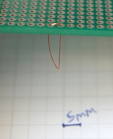

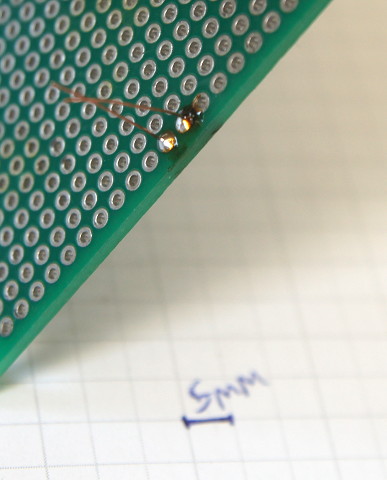

Use bare wire, without of an insulation. You may use larger flexible wire if you split the thick wire strand into single wires.
I believe the most hard work will be de-soldering of existing jumper pins. You may heat the pin from bottom side until the top plastic start to melt and you will be able to pull the pin by a tweezers. Don't pull to early and too strong to not pull out the PCB traces. After you clear the holes from old jumpers, place new ones.
Step one. Prepare a thin bare wire from a larger flexible wire strand:
.jpg   Step_one_single_wire.JPG (Size: 52.79 KB / Downloads: 686)
Step two. Bend the wire to insert into the holes:
.jpg   Step_two_bend_it.JPG (Size: 109.76 KB / Downloads: 667)
Step three. Insert the wire:
.jpg   Step_three_insert_into_the_holes.JPG (Size: 28.52 KB / Downloads: 1,019)
Step four. Solder it using a neutral soldering flux:
.jpg   Step_four_solder_it.JPG (Size: 38.11 KB / Downloads: 723)
Step five. Cut the tails.
