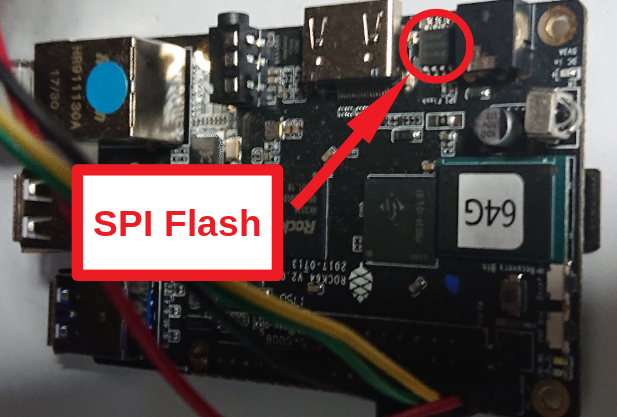

Thank you for addressing my questions. I need to clarify what I meant when I queried about U-boot.
What I am really asking is, does installing U-boot write a boot partition inaccessible to dd?
The first step of the tutorial is to install U-Boot in the SPI flash from the ROCK64.
The boot process:
- Firmware (Closed) from the ROCK64 looks into SPI flash and execute U-Boot.
- U-Boot loads the OpenBSD loader from MicroSD or emmc and execute it.
I hope I could clarify that.
(08-07-2018, 06:09 AM)krjdev Wrote: The first step of the tutorial is to install U-Boot in the SPI flash from the ROCK64.
The boot process:
I interpret your statement as follows.
Step 1 of the guide explains the placement of U-Boot, which is the (pre)bootloader, on the flash media.
Step 2 explicates the installation of OpenBSD along with /its/ bootloader on the same.
Booting into 'BSD requires both U-Boot and OpenBSD, in succession.
No, U-Boot and OpenBSD is not on the same memory device.
U-Boot -> SPI Flash
OpenBSD and loader -> On the eMMC or the MicroSD
The SPI flash is an additional IC on the ROCK64 board. It's an EEPROM which communicates via the SPI interface.
The SPI flash is NOT the eMMC or MicroSD.
The description of the SPI interface
The description of an EEPROM
Sorry, for my adoption. But I think you didn't know what a SPI Flash is.
I have added an attachment where I have marked the SPI Flash on board.
