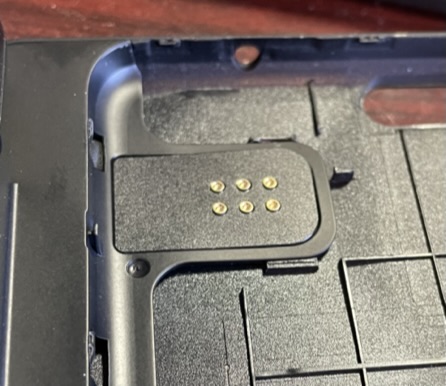

1. Fix the keyboard case's pogo pads
First, the hardware of the keyboard needs to be hacked a bit. It won't work out-of-box. Locate the Pogo pin pads in the back cover of the new keyboard case where the phone's pogo pins are supposed to make contact. The pogo pads on the keyboard case will not make contact with the pogo pins on the back of the phone unless you do something to raise the pads.
I carefully pried the plastic holding the pogo pads from the back of the case and slipped a small folded strip of paper beneath them. The plastic holding the pads is glued to the case (which will be the new back of the phone case) and can be pried away carefully. There were no screws in my keyboard case holding the pogo pads.

Mind posting a photo of your shims? When I shimmed the keyboard, it stopped working on my Pro but started working on my PinePhone (though only the keyboard, no charging). So I would like to see what a successful shim looks like for reference.

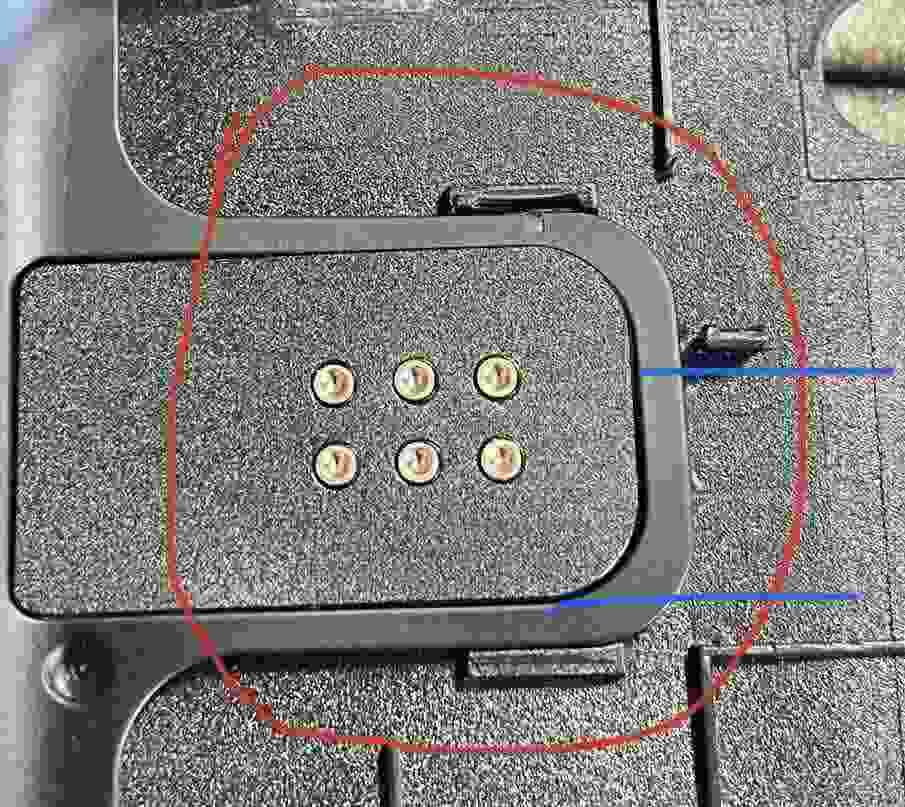

(02-25-2022, 09:08 AM)ragreenburg Wrote: Mind posting a photo of your shims? When I shimmed the keyboard, it stopped working on my Pro but started working on my PinePhone (though only the keyboard, no charging). So I would like to see what a successful shim looks like for reference.
I think this comes down to raising the 6 pogo pins and I apologize for my reluctance to undo my shim and redo it, but I will describe what I did as best as I can.
First, carefully pry the circled area away from the case. It is secured with glue and will pry away. Do it slowly, being sure not to break the plastic. It only needs to be pried away enough to slide a piece of paper folded a couple of times so that the paper shim can be slid from the right side back beneath the pogo pads on the far left so that all pogo pads are raised.
I cut a strip of paper that was narrower than the blue lines, which it will need to slide between (from the right side of the pogo pads). I folded this small strip of paper twice, so it was 4x thickness and about the size of the pogo pads. Then I slid it under the pogo pads from the right side, sliding between the two raised plastic pieces that surround the pogo pad plastic and angling it 'north'.
Here's a pic from an angle that is supposed to show how the plastic holding the pogo pads is now warped by the shim beneath it, forcing the pogo pads away from the back of the case to make better contact with the pogo pins on the back of the phone.

Thank you for the pictures! When I tried pushing the paper underneath that pin pad I got a lot of resistance and didn't want to push any farther because I thought there was a ribbon cord there(?) and didn't want to brick the keyboard. Is there anything under the pin pad to keep an eye out for?
(02-25-2022, 12:05 PM)ragreenburg Wrote: Thank you for the pictures! When I tried pushing the paper underneath that pin pad I got a lot of resistance and didn't want to push any farther because I thought there was a ribbon cord there(?) and didn't want to brick the keyboard. Is there anything under the pin pad to keep an eye out for?
I believe the resistance you are encountering is the glue. I was able to raise the plastic tab holding the pogo pads enough to slide a piece of paper all the way under the left-most pogo pads. So I believe the ribbon extends from the left of the pogo pads, not from directly beneath them.
