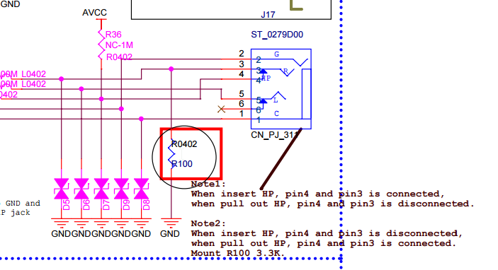

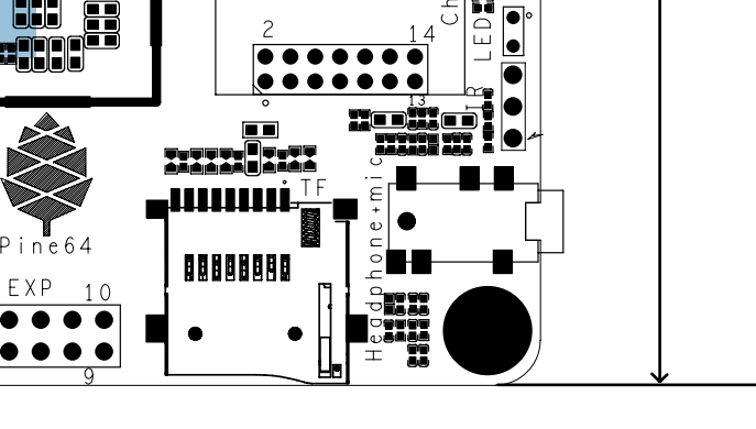

At the schematic is there a note2: Mount R100 3.3K This resistor is a very small 0402 resistor (less and 1*2mm)
I can't see where is it should be located at the PCB.
Do anyone know if this issue will be solved if R100 is mounted (if not mounted already)?

I have tested if a 3.3K resistor between pin 3 and GND will make any difference. No still no audio output unless I do a unplug - plug operation at the HP_JACK output.

A manual short circuit of pin 3 and 4 reset the HP_JACK audio output. when the short circuit is removed is the audio output activated.
I will now see if I can write an app or a small script to do this (setting / resetting a GPIO pin controlling a analog SW device and thereby make the short circuit)
