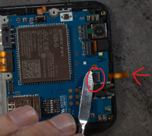

The touch screen is managed by a small ribbon cable (red arrow) that is plugged into a small connecor (red circled).
See the attached picture.

(02-12-2020, 04:08 PM)drpi Wrote: The touch screen is managed by a small ribbon cable (red arrow) that is plugged into a small connecor (red circled).
Yes, thanks I found that by watching the video that I linked.  As I mentioned in my post I reseated the connector several times with no effect.
Have you checked the solder joints of the connector with a magnifier ?
Quote:Have you checked the solder joints of the connector with a magnifier ?
I looked pretty closely with my unaided eyes but I suppose that is a good idea.  Maybe there are some bridged traces.
