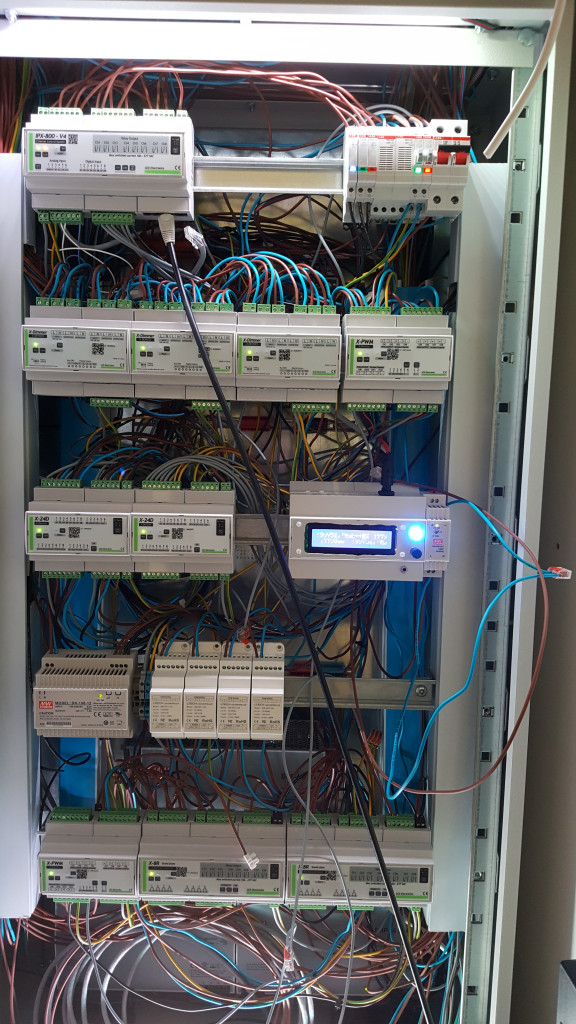

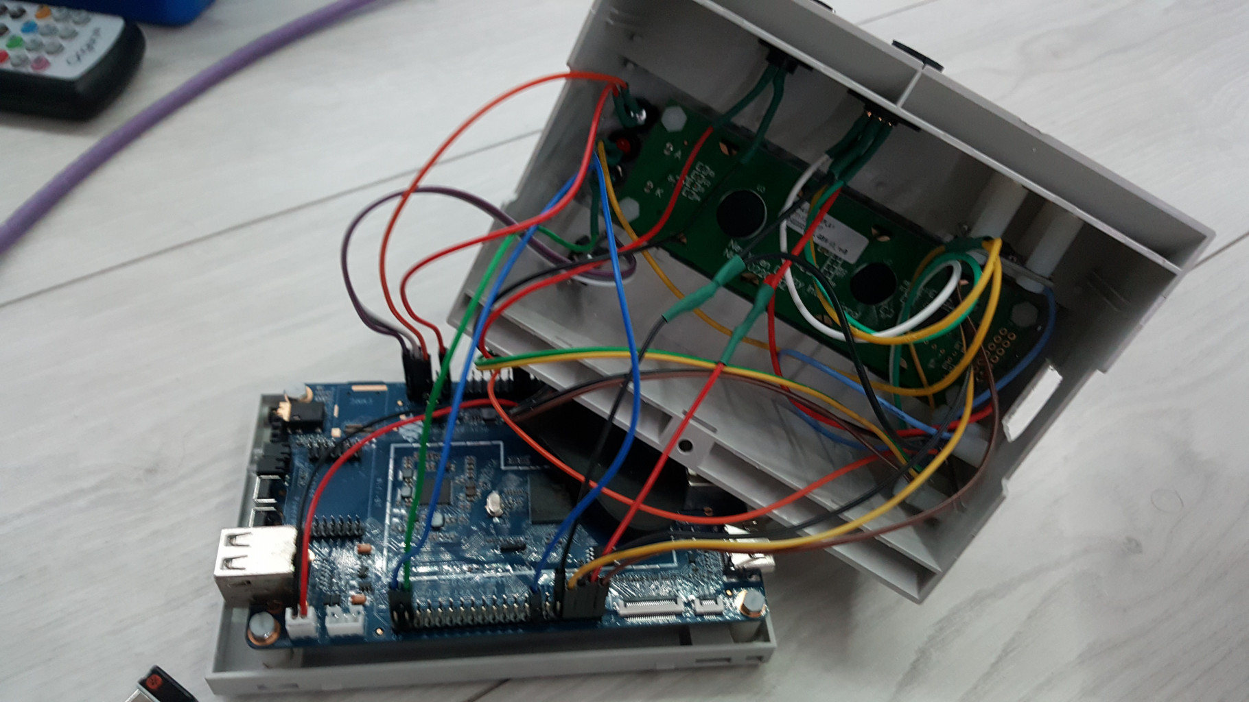

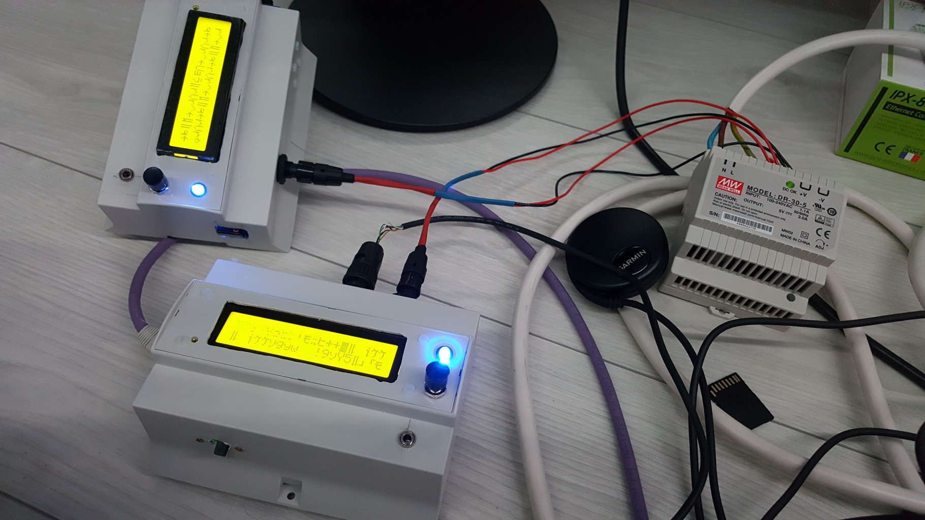

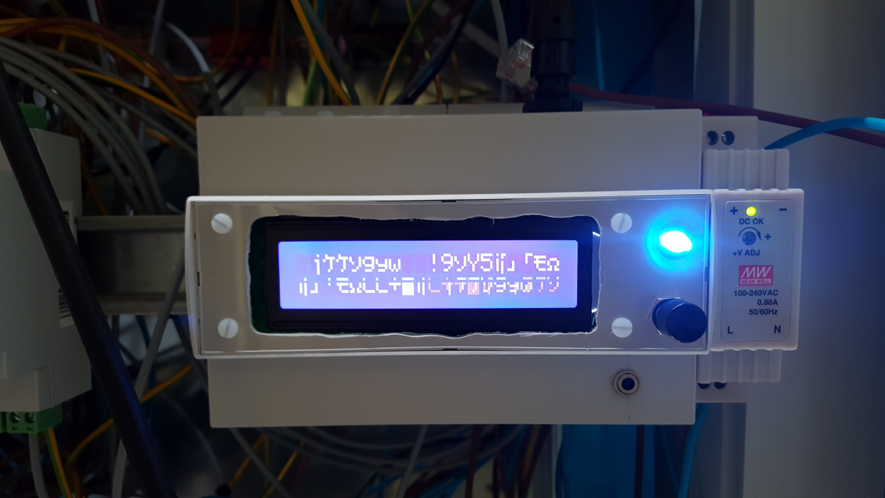

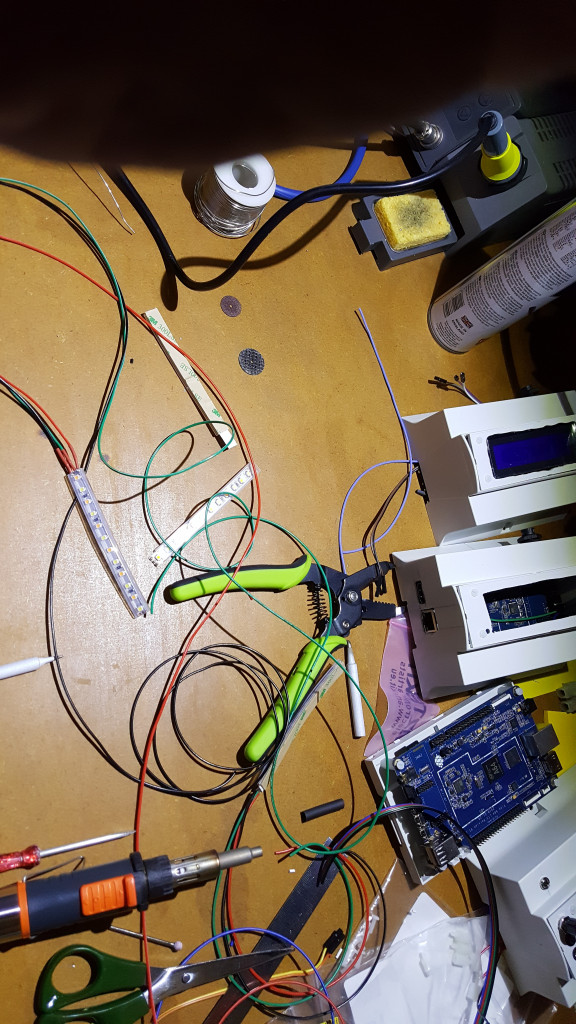

It has taken a long time to respond and actually get the project running because I have been extremely busy.
Here is the project so far:
I have 3x Pine64-LTS now and added 4x Artekit TTL -> RS232 level shifters to them https://www.artekit.eu/ak-3232-usage-guide/
3 of these are linked to Newhaven Display LCD displays: https://www.newhavendisplay.com/nhd0220d...-5742.html
The last RS232 level shifter is connected to a Garmin 18x LVS GPS receiver: https://buy.garmin.com/en-US/US/p/27594
I created custom cables using 20cm Jumper cable and Switchcraft Conxall Mini 6P connectors for the GPS and 2P Micro connectors for the +5V Power: http://www.switchcraft.com/Category.aspx?Parent=901
The GPS receiver PPS output is connected to the CTS pin on UART4 through the level shifter, but I also installed a 5V LED into the chassis which I am taking the PPS signal directly from the Conxall 6P connector.
For the chassis I am using an Italtronic 8M XTS: https://eng.italtronic.com/products/modulbox_xts_en/
For 2 of the Pine64 boards I am using 16GB SD cards and run FreeBSD 13.0-CURRENT on them, the other board running Armbian has a 32GB SD card.
Overall I found activating the UART ports difficult at first but in Armbian I managed to find the correct Overlays for them. I then used the same Overlay's from the Armbian git repo in FreeBSD which worked - though a slight modification was needed for the PPS signal of the GPS receiver.
To power the boards I am using 5V Meanwell NS35 DIN rail mount DR series switching power supplies.
Extra parts are Keystone standoffs; I used some PC104 kits and some 9.5mm 4-40 ones all Nylon type. The TTY terminal connected to UART0 is done using a Kycon 3.5mm stereo socket, this is used with an FTDI USB to 3V TTL console cable. Also I used E-Switch PS1024 panel mount push switches connected to GPIO pin and +3.3V connector.
Currently I need to write a driver for the Newhaven Display LCD's. I plan on using it with Lcdproc so I may have to port the driver from Lcd4Linux over. It is proving difficult as it's a little unclear how to send the command set to the display. Using the Hex codes is currently producing no result.
Here are some images of the project:
