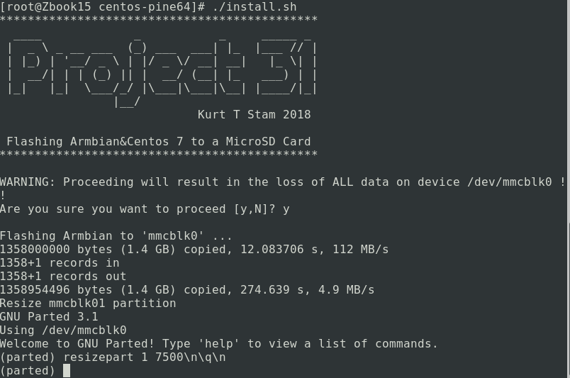

Hi Kurt,
I have inserted empty microsd and run install.sh, i am stuck on screenshot attached
Hi smnoufal,
You can try the ready to go image: https://project31.github.io/pine64/. I've created it running from the rock64 branch on https://github.com/Project31/centos-pine64/tree/rock64.
Cheers,
--Kurt
Thanks Kurt, for centos 7 on rock64,
I followed your instruction and glad to inform you that successfully loaded cenntos 7. once i tried to enlarge the sd card and rebooted as per your  instruction and it ffiled to boot. I think partition got deleted.
smnoufal
kurtstamHi smnoufal,
Cheers,
--Kurt

Hi  smnoufal,
1. So I take it then things work ok /before/ you try to enlarge the partition on the sd card?
2. I would re-flash the image and start over. I would try to take baby steps so you can pinpoint what works for you. Whenever you work fdisk you have to be careful.. Double check:
  1. name of the device (/dev/rdisk)
  2. using fdisk, use `p` to list the partitions
3. Try to capture the output when following the instructions and post it here. That can be helpful.
Cheers,
--Kurt
