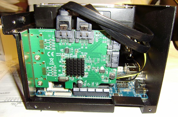

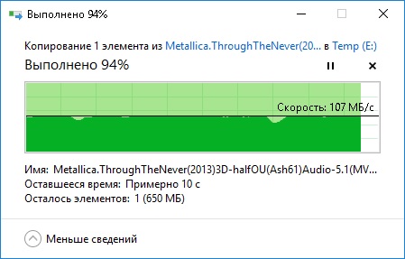

Successfully tested 9230:
https://forum.pine64.org/showthread.php?...7#pid40687

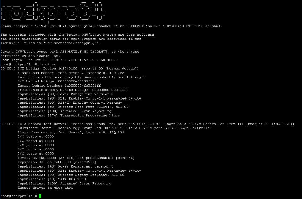

Checked Marvell 88SE9235 - Works !
(By the way, the SATA adapter from the store Pine64 broke after 1 month of work)

not quite, You have chosen with a different chip, Marvell 88SE9215, he is slower because uses one lane PCI-E
we are talking about chip Marvell 88SE9235 (non RAID) or Marvell 88SE9230 (Raid), using two PCI-E lanes.
https://www.amazon.com/CREST-Drive-Contr...3AIO+Crest
It works right out of the box, not doing anything in the system (I personally did not do anything).
Yes
