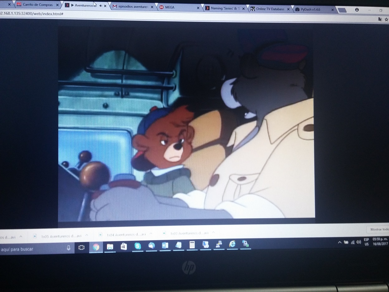

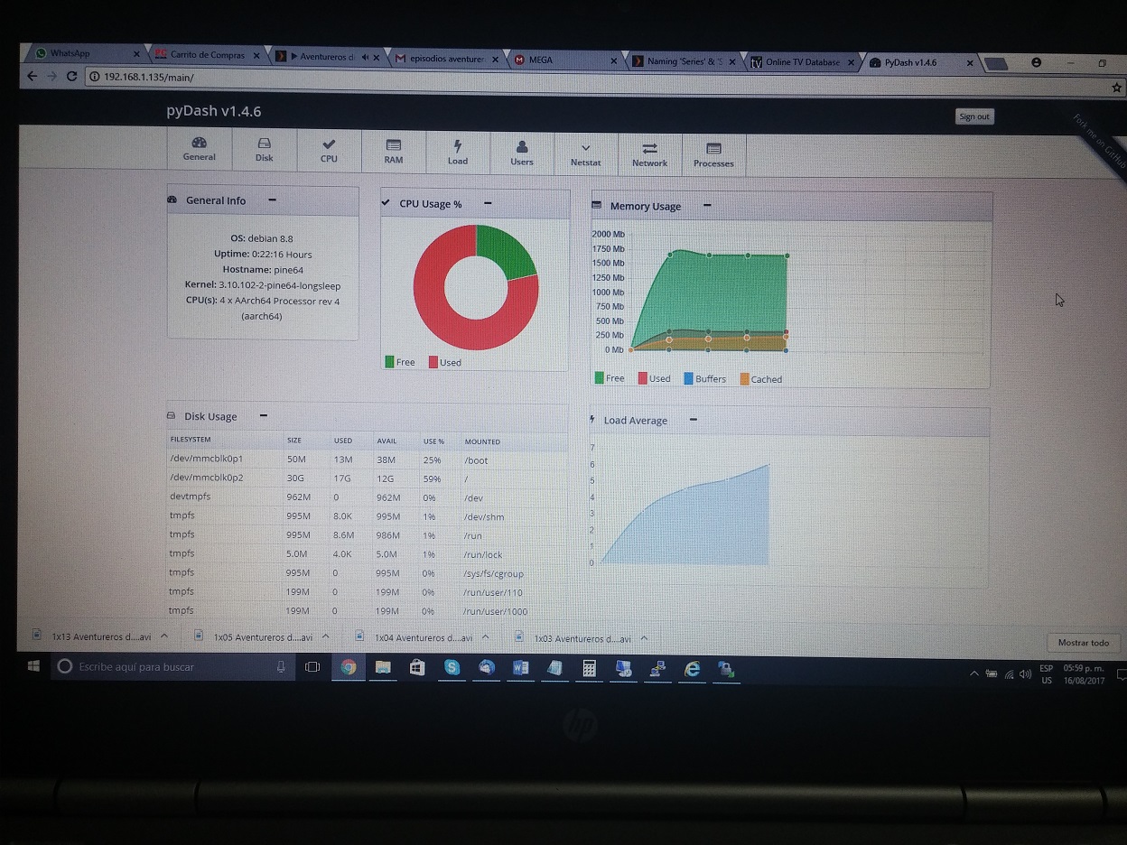

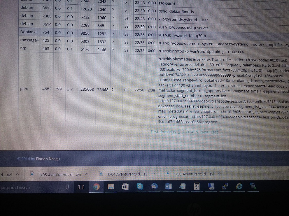

I dunno. first im trying to be accesed from the outside. I was reading that with transcoding is not good, but with directstream has to work well. I will try it tonight.
I will try to access from outside from home... but these are the results of playing a series in plex... Standard definition.  Too much cpu use xD
