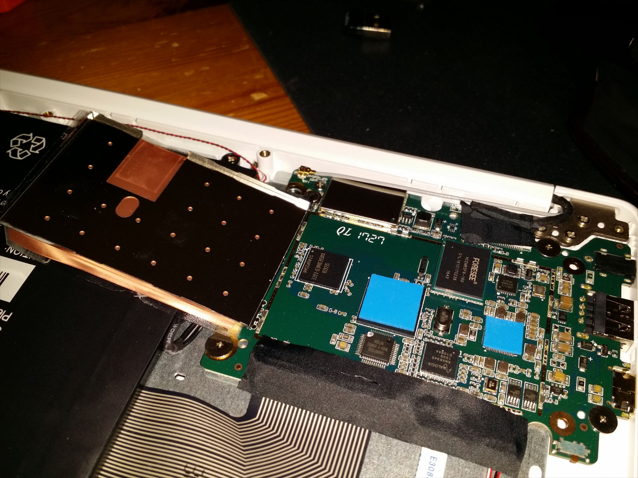

I just disassembled my Pinebook and noticed the thermal pads were installed in wrong order. If possible could anyone else from the latest shipment check if their one is done right. If this is just isolated case.
So how they should be placed afaik is that the bigger pad is on the CPU (big A64 label) and smaller one on AXP803. Mine were reversed.

Well I have only pics after I corrected the issue. But I have attached a pic of how they should be. They were installed the other way around when I received my unit.

It seems that my thernal pads are installed correctly - but a little misaligned  at the cpu...
i just received my pinebook and had my thermal pads swapped as well, fixed it~
