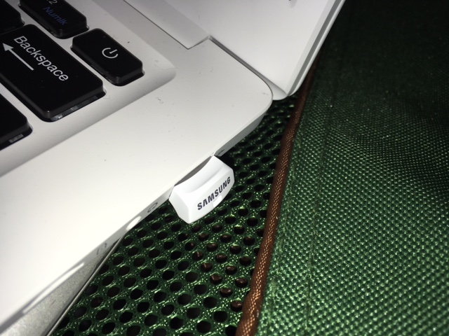

New thumbdrive came in today! 64GB and no bigger than the little wireless attachment for my mouse. Will attach pics so you can see the size and then show you what the configuration looks like live (can provide some instructions for step-by-step but I suspect that most folks really interested in this may need only minimal guidance at most.
So i installed the drive, and as usual it was formatted for Windows. I actually don't mind this for now as I'm just putting backups on it and can use it to more easily transfer certain files back and forth from a win host (and Linux has no trouble with the Win FAT32 (LBA) filesystem), but I deleted it and set a new one up of 53GB size (total disk was 59.8 using full binary gigs) and the rest in swap.
added this line in fstab so it will only try to mount if Linux sees it and runs at a lower priority than the zram swap volumes:
/dev/sda2   swap   swap   sw,nofail,pri=1 0 0
