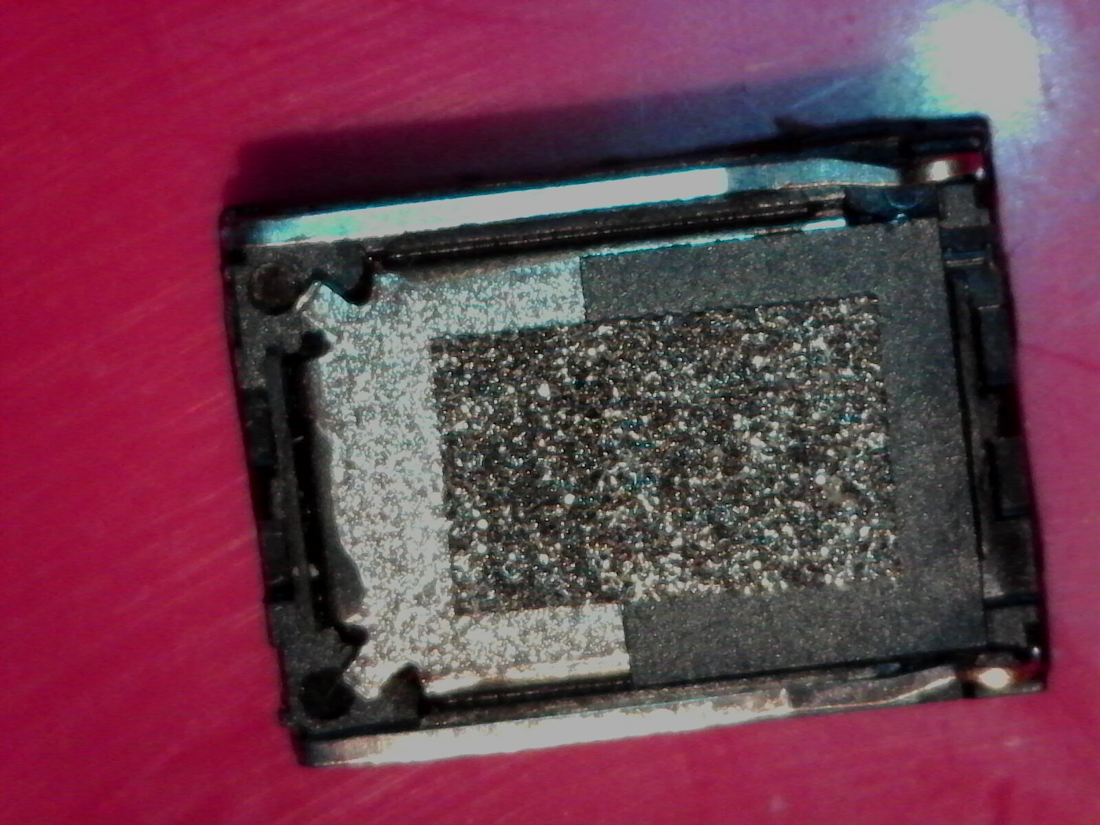

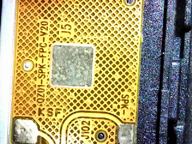

I see the same dimples on the flex board speaker connectors as I see on mine. I fixed a couple by tinning the dimpled pads with solder, the other I did that and replaced the piece with the speaker in it all pine phones talking. attached couple pics. Anyone know where you can get the speakers best guess at deminsions 12.2mm x 15.2mm x 2.75mm
