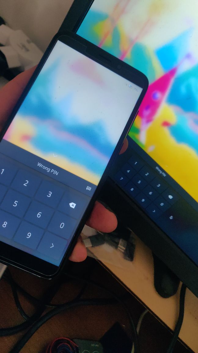

At least on Manjaro KDE it is not possible to unlock the phone in convergence (where would I report this issue?):
[Image: b737c7ca39d7c2455c3d98dd44b0af9cc5702127]
