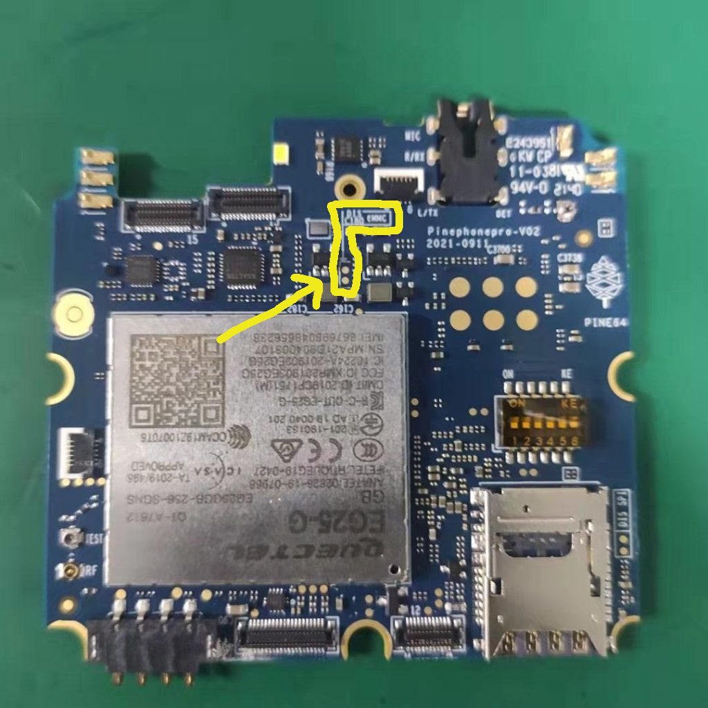

This is a simple question but I would like to know where to find the 'bypass contact points' on a _developer_ edition of the PPP.
Not needed at this time but we never know Smile
(03-03-2022, 04:38 AM)cyrelk Wrote: This is a simple question but I would like to know where to find the 'bypass contact points' on a _developer_ edition of the PPP.

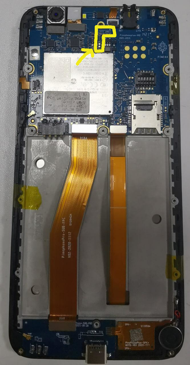

It was pointed out in the community chat that this question was unanswered. The contacts can be found to the top right of the modem's RF shield after removing the midframe.
NOTE: This only applies to Developer Edition phones, which were sold to a limited amount of developers in 2021 after they filled out a special application form. Every later edition have the RE button. If you are unsure which edition you have, then you DON'T have a Developer Edition!
Photos:
