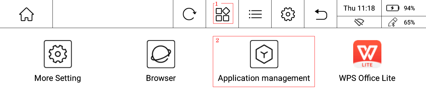

To start with, open up the app list, highlighted as 1, then open application management.

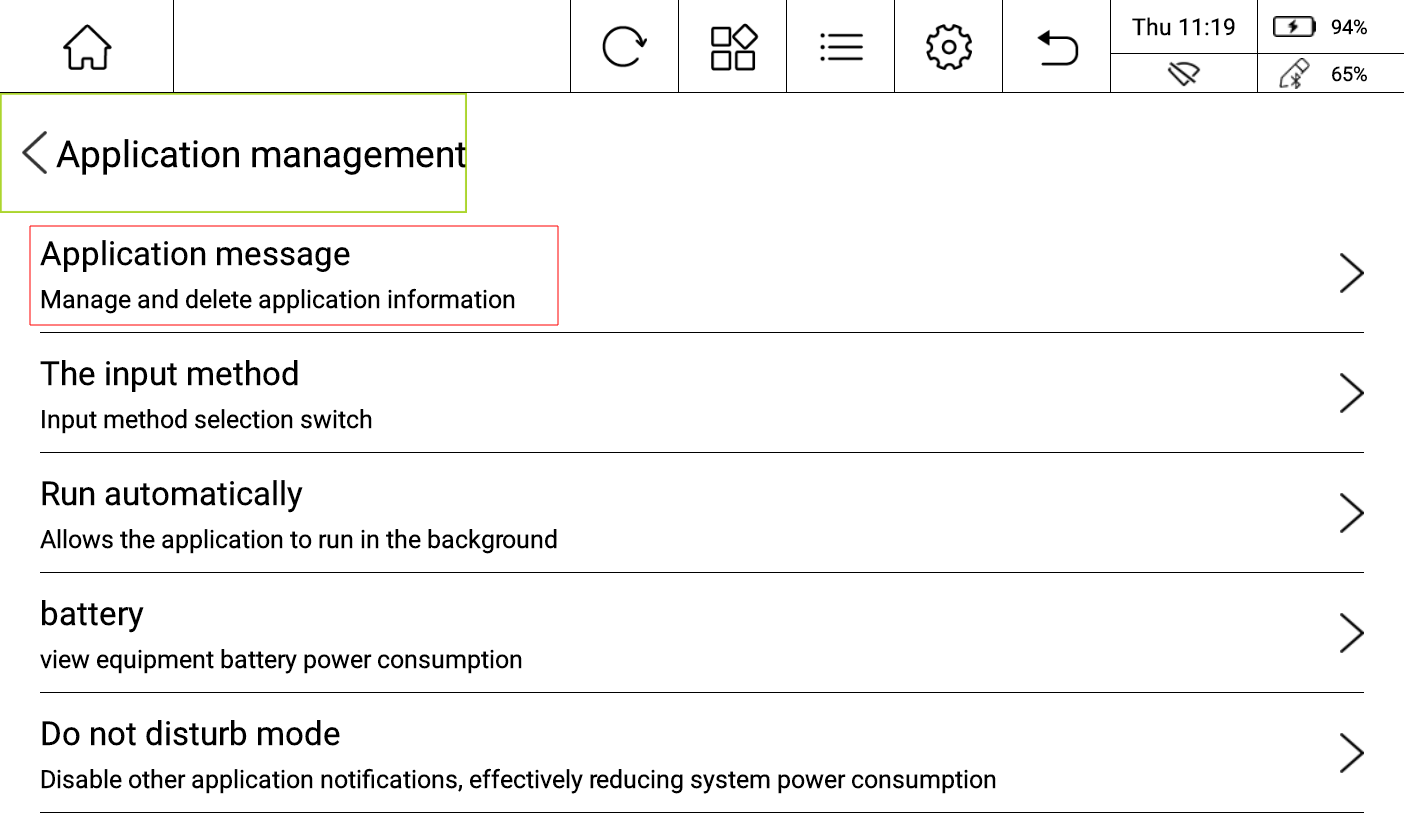

Next up, "Application Management" again.

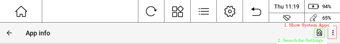

This opens up the Android "App Info" panel, but it doesn't have a search box like much the rest of Settings has, so it can't search to the root of the settings panel.  Use the far right 3 dots to "Show System", then search "Settings".

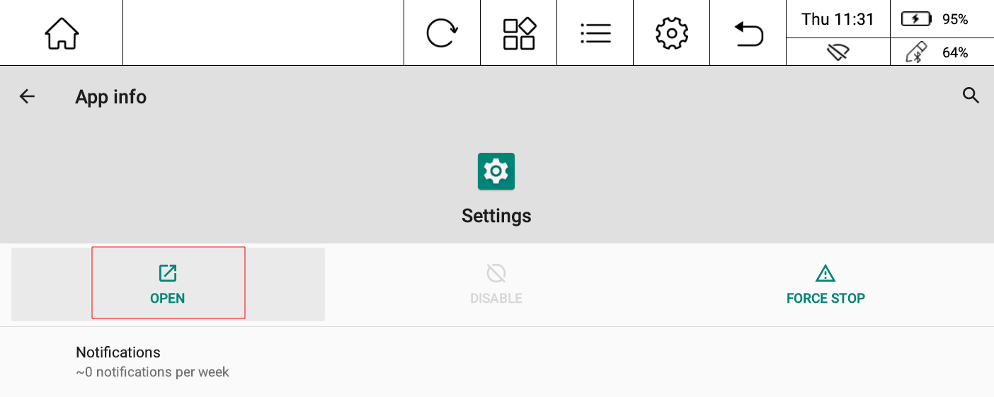

Lastly, click open, and the root of the settings app opens up.
